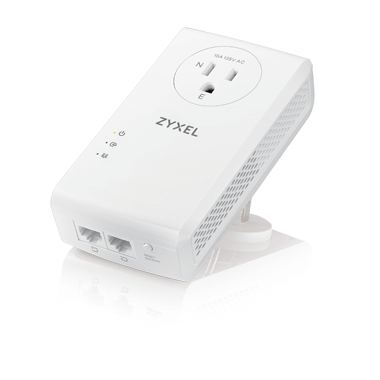

What model power line adapter are you using? There are several choices and seems like yours are solid. Or is there a better choice today that people would recommend? I used an old model from my brother that he wasn't using to try and it was a little flaky
In my day we programmed our infinite mistakes with gotos and liked it!
I use this. There are definitely cheaper ones out there, though, depending on your speed needs. I have one of my security cameras streaming 24/7 to an NVR on these, and no dropouts to speak of that weren't power outage related...
Thanks. That is how I was trying the old version that I had trouble with was for streaming a HD camera signal to my NVR
I'm using a TP-Link that's about 4 years old.
The Zyxel model above are rather large, but seem to work VERY well based on my experiences with them over the last 18-24 months.
