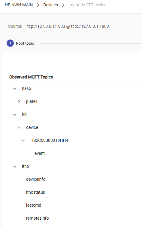

I'm using the integrated (in beta) MQTT instance to importdevices into hubitat.
This seems to work, but for one device not so much.
This week I got a new powerwaal from Jackery.
Seeing it has an integrated MQTT push functionality (primarely for HA) I wanted to connect it to Hubitat to be able to read the battery state and the current load.
So I entered the Hubitat MQTT adress and credentials in the Jackery, but it shows up strange in Hubitat.
The device is under "hb", but only "event" is seen.
Looking at the dev pages, it shoud have more topics (see GitHub - Jackery-Official/jackery · GitHub )
Is this perhaps because in the builtin MQTT server there is no way to authenticate the connection with a generated token?
The only usable topic you have, for now, is event. Do you have MQTT Explorer?
I agree with @nckepa MQTT Explorer is really the best too to see what is going on with the topics. I use it all the time for my weather observations and I am currently testing the MQTT function to allow Meshtastic LoRa messages to be sent to my Hub.
MQTT explorer shows more data, but still not enough.
  "type": 23,
"eventId": 0,
"messageId": 0,
"ts": 1788024255,
"deviceType": 3,
"body": {
"deviceSn": "HQ2C09000487HP3",
"devType": 1,
"subType": 0,
"outEgy": 238,
"inEgy": 281
Looks like it needs the token reported back, else it will not give all data and setpoints.
Hopefully we will get more MQTT support in the future. Its hard to assign multiple attributes in an ideal way.
