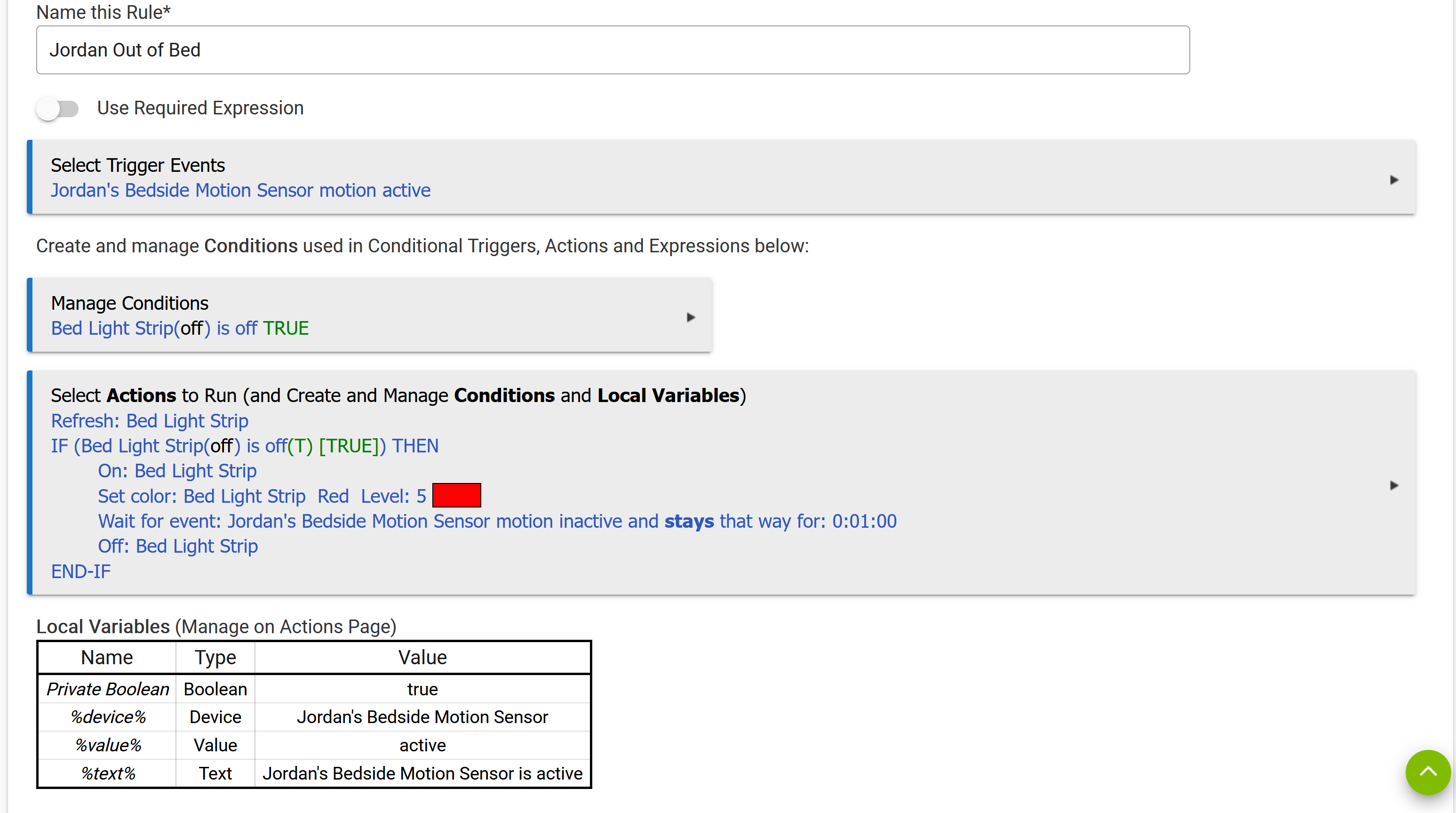

I am a newbie to Hubitat and have ran into two issue with my motion sensors + light strips.
The first issue comes from my rule sometimes not working. Here is my rule, as well as a log of my rule not working:
You can see that a bedside switch was double tapped. This turned off the Bed Light Strip, just like I wanted. I then have a rule that when Jordan's Motion Sensor is active, the Bed Light Strip turns on, IF the lights weren't already on. In the log, the rule states the Bed Light Strip is on. This isn't the case, as the log shows that the Bed Light Strip was turned off.
I have checked the device on Hubitat and it says the Bed Light Strip switch is on. It's not on, however, as confirmed from my button double tap and just looking at the lights. Any idea what's going on here?
My second issue comes from the same rule as above. The rule states that after a minute of inactivity, the light will turn off. Occasionally, the light won't turn off however. I haven't seen the log on this, but all I can think of is the motion sensor won't trigger the inactivity, as this should be the only thing preventing the light from turning off.

Still having issues. Here is my log for my second problem:
Per my rule, after "Wait for event: Jordan's Motion Sensor motion inactive and stays that way for: 0:01:00", the Bed Light Strip should turn off. In my log, the "Off: Bed Light Strip" action is skipped. This results in my light staying on.
Secondly, I reduced my polling interval down to a minute. The device polls every minute now, however it doesn't correctly poll the switch status. The device will say it's on after polled, when it is off. I found out when I hit the Refresh button, the device switch status corrects itself. I've added a a "Refresh: Bed Light Strip" to the top of my rule and it seems to be working.

Your Wait for Event is being canceled becsiee your rule was re-triggered (that is how waits work if you don't know; see: Rule 5.1 | Hubitat Documentation).
From what I can see, you never shared you entire rule, only your actions. The trigger events (and required expression, if used) are important pieces to know when troubleshooting a rule, so I would suggest that.
You’ll want to modify your rule slightly to prevent it from re-running. Try adding the following:
Required Expression: Private Boolean be true
Then in actions, have your first action after the if to set the Private Boolean to false. Your last action before the end-if should set the Boolean to true. This will keep your rule to only one instance at a time.

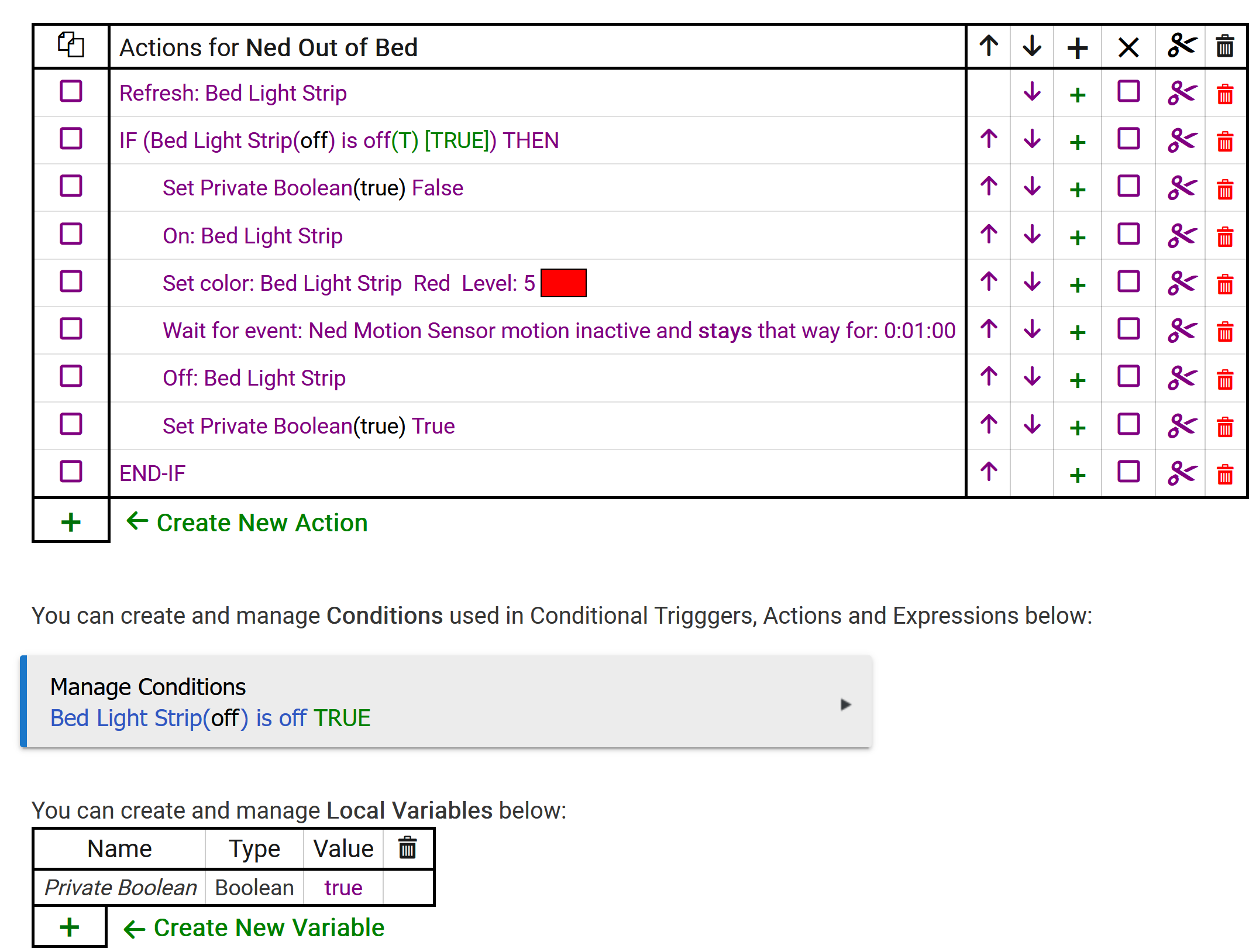

Thanks for letting me know. Here's my rule here. Does this include everything?:
Thanks for this. Here is my updated rule with the Boolean. Did I do this correctly? Looks like I need to look into the rules more and get comfortable with them.
Also FYI, I have two of the same rule in my Hubitat. One is triggered from my wife's motion sensor. One triggered from mine. Wonder if this is causing issues?

The updated rule will work as long as you have a required expression of the Private Boolean being true. The rule will only run one time until the Boolean gets set back to True.
As for having a rule for your wife's motion sensor, that would not be an issue as long as you have the same Private Boolean in her rule. Basically, this would allow for only one of the rules to be active at any given time.
