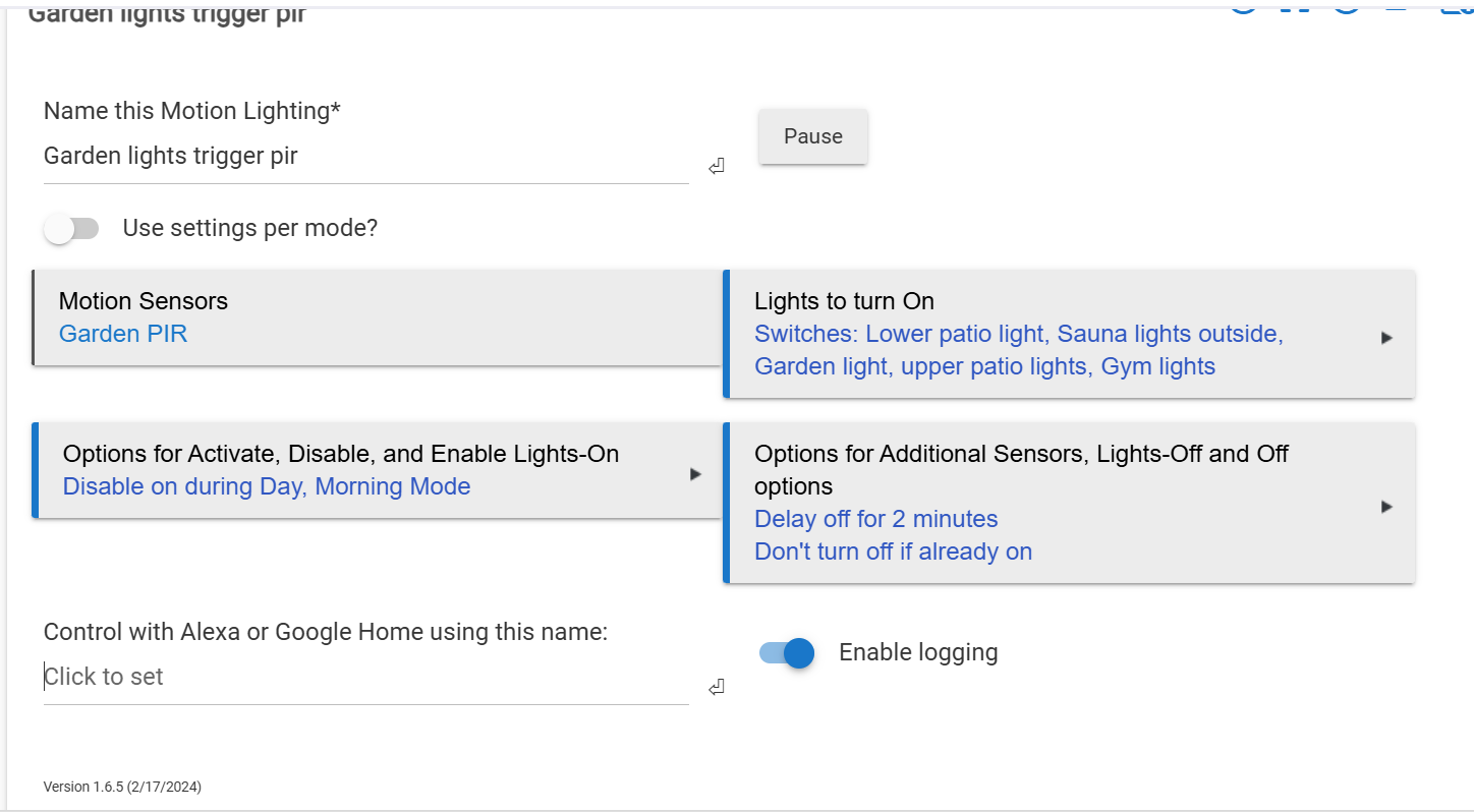

Have the below rule running.
"Sauna lights outside" gets turned on with rule +20 minutes sunset, the rest are manually dashboard operated.
initial state as expected. all lights off except sauna light outside. Motion occurs and all lights come on. after time out all lights go out.

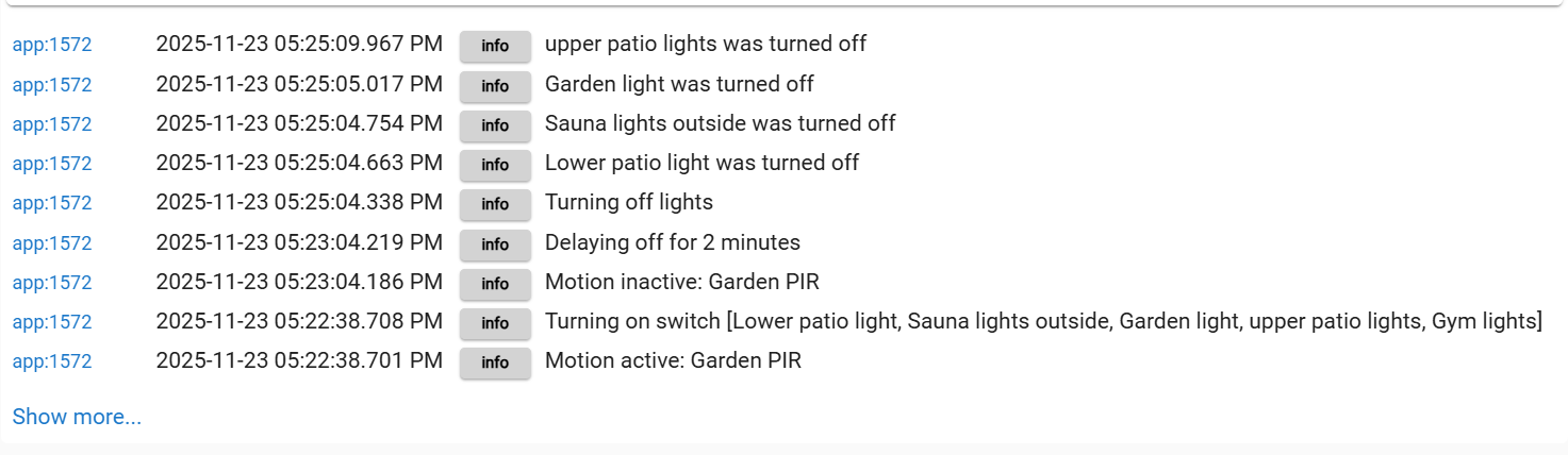

This is log of the app running:

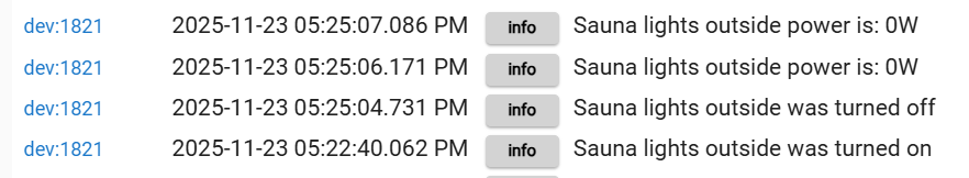

This is log of sauna light outside

Looks like "Sauna lights outside" wasn't on -- or at least wasn't reporting as such -- before the first hints of this app running at 05:22:38.701 given that it reports an "on" at 5:22:40.062, presumably in response to that. What was the "switch" state of the device on the hub at the moment before the Motion Lighting instance first ran? (The cut off logs might reveal this, but the "Events" tab on the device is the authoritative source, or you can look yourself at "Current States" if you catch it at the right time.)
I can quite confidently say Sauna lights outside was on as I can physically see it with the dashboard reporting "on". That is why I am confused by also seeing "on" on the log. I have also turned on via the dashboard the other lights pre trigger, and they too get turned off.
here is the execution log of the sauna outside light. I turned it on via dashboard at 5:11 you see it reports power as a motion had already turned it off this evening.
