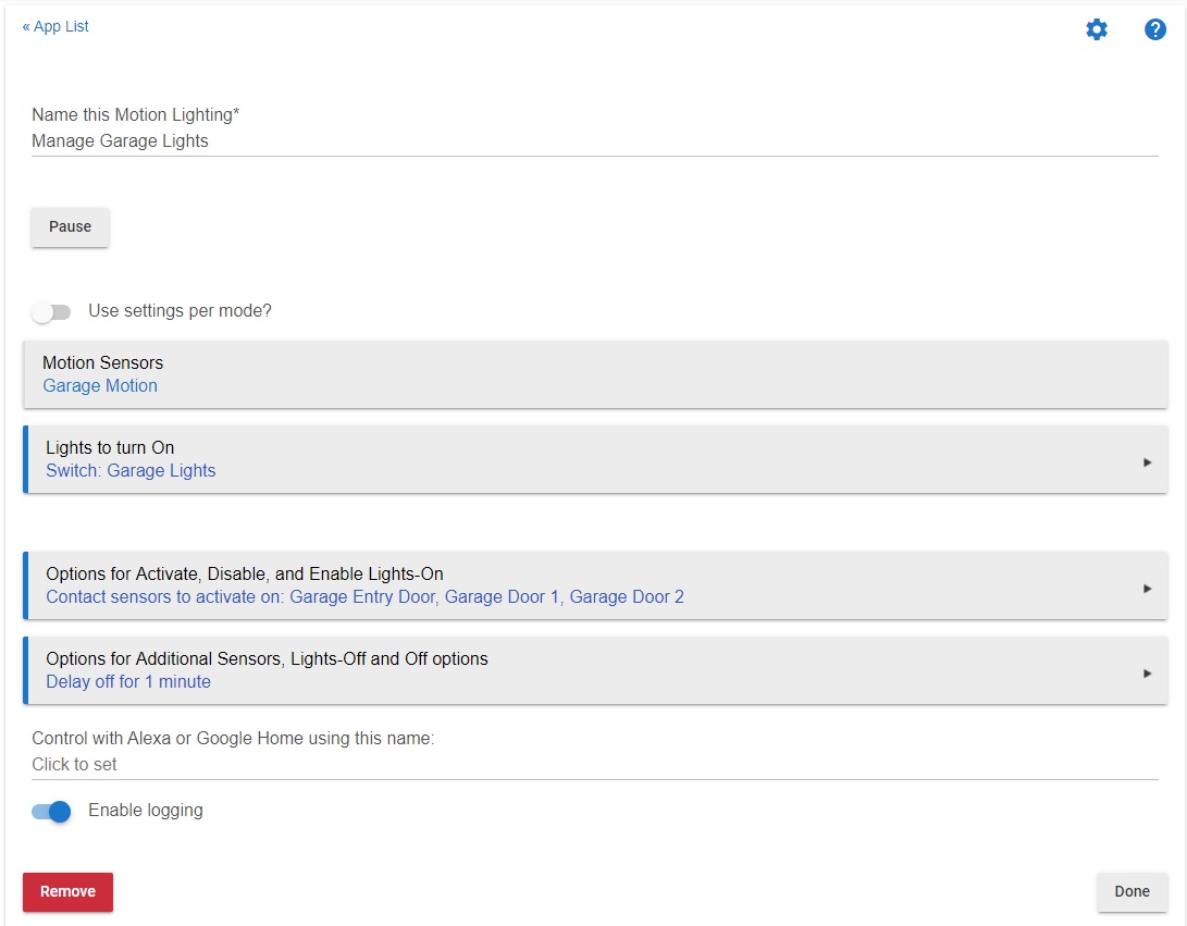

I have several old RM rules that I'm just now getting around to moving to Motion Lighting. The first one I set up, i figured should be really easy (the RM rule isn't too complicated) but it's not working like it should.
Setup (screenshot below): If the motion detector in the garage is activated or if either garage door is opened or if the door into the house from the garage is opened, turn the garage lights on. After 10 minutes of inactivity, turn them off (set to 1 min for testing).
Problem: On works just fine, but the lights never get turned off.
I assume I'm doing something wrong...

@jon1 - I've tried with and without them in the off section. Doesn't seem to change anything.
@billmeek - My testing is actually triggering with opening the door from the house to the garage. It's slightly out of sight of the motion sensor, so I'm not tripping the motion at all.
Show the logs from the app. They should explain what it's doing. And, if you want the lights to turn off after the door is closed, you do need the contacts in the Off options.
Ok, some logs below. What I'm getting from this is the actual delay only appears to kick in when motion goes inactive. If motion isn't part of the chain of events at all, it doesn't seem to even enable the "delay" (but did eventually turn off 7 minutes later).
First logs: rule active, but motion sensor never tripped (it's on the far side of an oversized 3-car garage)
Second logs: rule active by door contact, but then motion gets involved as I'm rummaging around in the garage. Delay pops up immediately when motion goes inactive.
OK, that's expected behavior. This is Motion Lighting, not Motion and Contact Lighting. Having the contact sensor turn on the lights is like having a switch turn them on -- it is not the main actor. To do what you want you will need to use Rule Machine.
