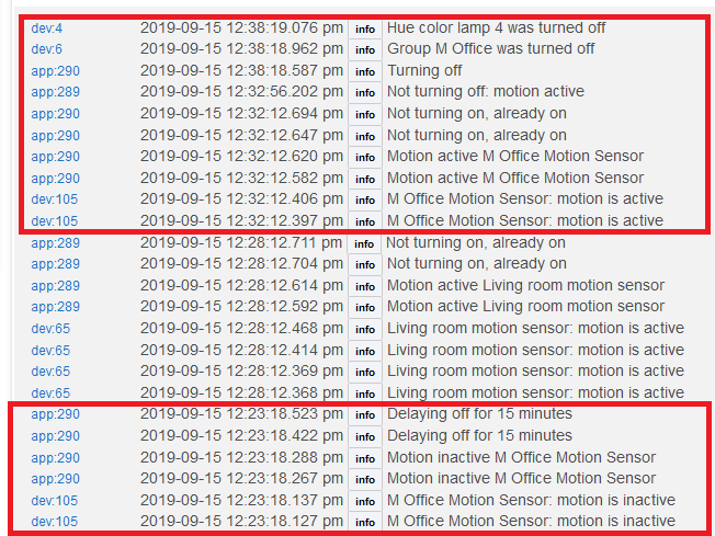

I've noticed recently my motion lights have been turning off even when there is active motion. It appears new motion detection does not cancel delay timer as the lights will turn off after the delay even when motion is active. Do I have motion lighting configured correctly?

Logs, red highlights were motion went inactive & delay then new motion but lights went out anyways.

What do your logs show? Screenshots of the ML app settings?

Is it likely that there just isn't enough actual motion for the sensor to pick up? WIll it see motion if the heat signature doesn't change much due to a lack of movement? When the light goes out, if you wave at the sensor or move, it comes back on. I experience the same bahavour in my office with an Innovelli 4 in 1 sensor as the trigger. You have me thinking that may be the root cause.
