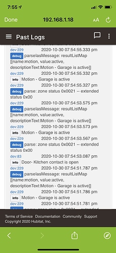

Here are a few images from just now. Not turning on even though motion detected. Didn’t manually turn anything on or off but days I turned something off manuall

So in my case I didn't turn anything off and confirmed inactive motion before trying to trigger the rule.
Disabled the the setting as stated above and still have this issue. So it’s either the rule not kicking off or the switch having issues since the motion detector does at least recognize motion.
