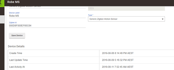

hmmm - clicked that first option and went in and the motion sensor green light is firing, but there is nothing in the logs now.
When i go to the device it has 99% battery but its saying the last activity was 752am this morning.
might do a battery pull and a restart of the hub.
