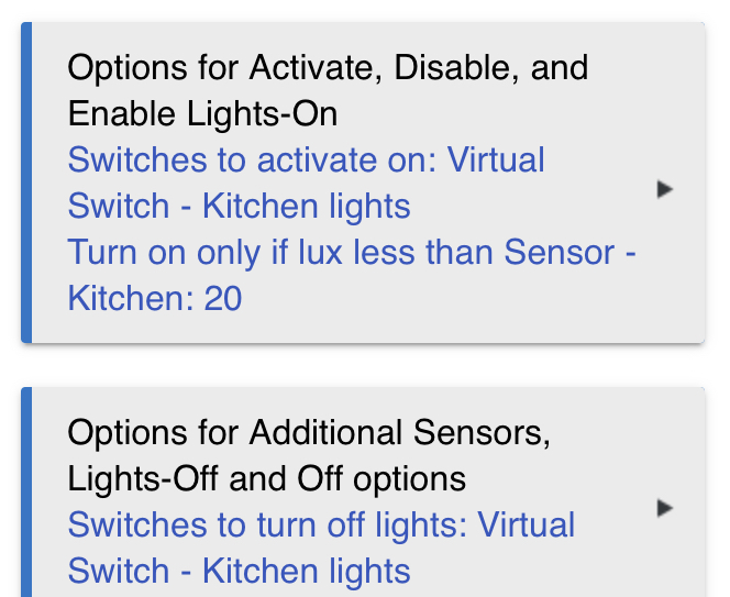

I’ve got a sensor in the kitchen which turns on the lights on motion if the lux level is below 20.
The lights are not smart so I’m using an Aeotec Dual Nano Switch to make them controllable and the Aeotec Switch also allows me to keep the traditional mechanical light switches in place. When the light switch is used it toggles the virtual Switch which in turn also triggers the motion lighting. I configured this last night and tested it and it worked great. I turn on the lights manually and after the set amount of time ML turns them off again.
However, this morning I couldn’t get it to work again. When I turned on the lights with the light switch, ML wouldn’t record the on event which in turn means the lights would now be on until I manually turn them off again. Less than ideal... When I turn them off with the light switch, ML registers the off event.
I realised that what is causing this issue is my lux condition. Since it was lighter than 20 lux, ML decided to just ignore the on event from the manual switch.
Is there a way to configure ML to adhere to the lux requirement for a motion event but if a button or switch is used to turn the lights on it will discard the lux requirement because the human has obviously decided that they would still want to turn on the light?

The light switch would be used to override the condition of my motion lighting rule. Since my ML rule only fires if it’s dark enough, I can use the switch to turn on the lights even if it’s not dark enough for the rule to fire.
In this particular instance I have a few sets of lights in the kitchen and when one set is already turned on, it’s not dark enough for the motion lighting to fire to turn on another set of lights. I don’t want to increase the lux threshold either because then the lights turn on in the middle of the day with no other lights on and when the light doesn’t need to be turned on.
What I’m basically looking for is a configurable switch in ML to toggle whether the button or switch which can also trigger the ML rule should also adhere to the lux conditions or not.
In my case I would set the rule to ignore the lux requirement if the ML rule is triggered by a switch.
