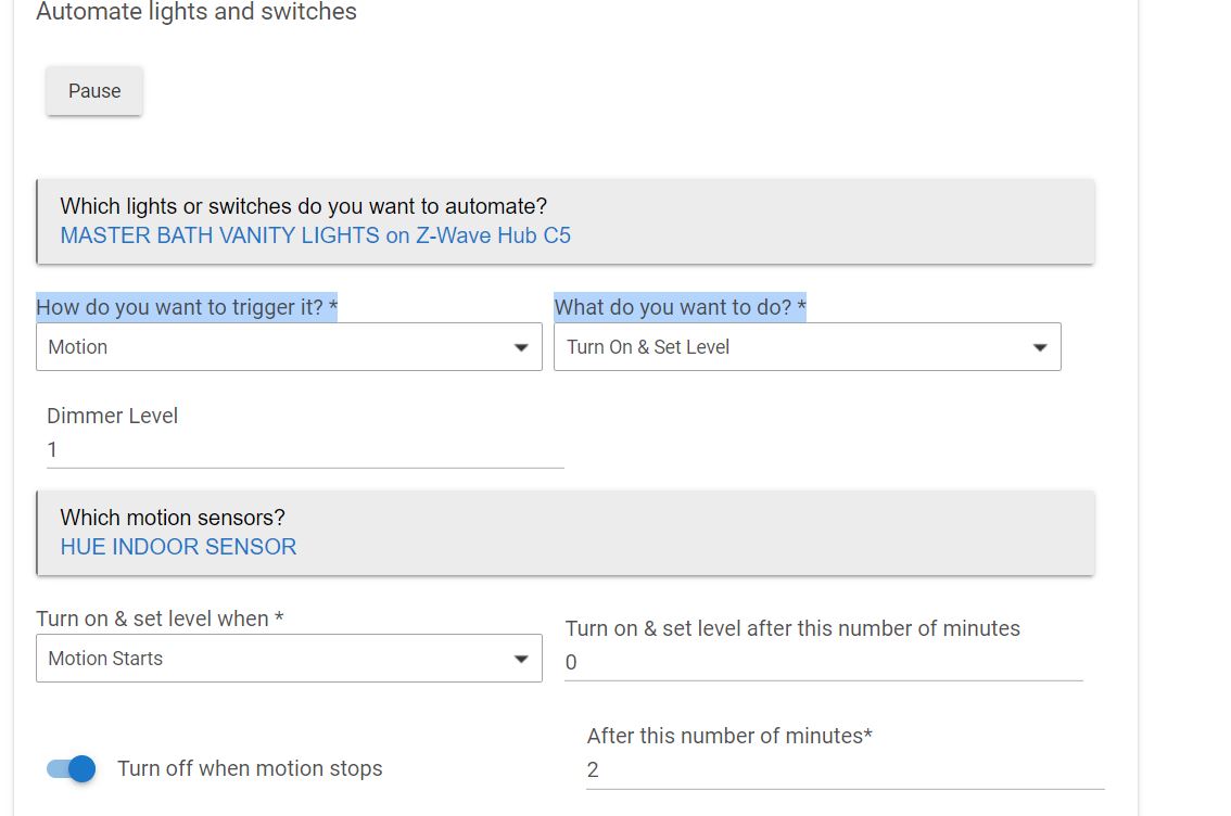

Excuse the 2 screenshots, I have not figured out how to grab a multi page rule. I believe this might be what you're looking for. This rule controls a bathroom vanity light with motion from a Hue sensor but the rule has a timer that is not wanted at certain times. Turning on the light from the switch disables the rule so the light stays on when needed.
If this is close to what you're looking for this may get you started in the right direction.
Edit, this is a simple automation rule.
