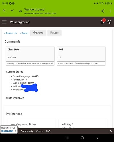

I've explored setting up a Wunderground account and creating an Api having added the virtual driver from the Package Manager. A Google search suggested that if I add a device to the site (which I don't actually have) it doesn't matter and I can still use the credentials.
Ive added them to the virtual driver but get no other response

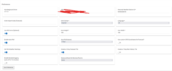

Your device page should look like this
Have changed the station code from the one it gave me initially to one I found locally which is online
I've checked the other settings and they look the same.

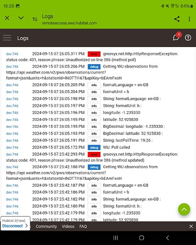

I've added the extra logging in and get this.
that doesn't look like a proper API key, mine at least is like 15 characters or so, yours is 8. Do you have a legitimate API key?
Thank you, yes you were correct. For some reason the site didn't display on my phone. I've created the key and put it in and I get a full list of variables and states.
