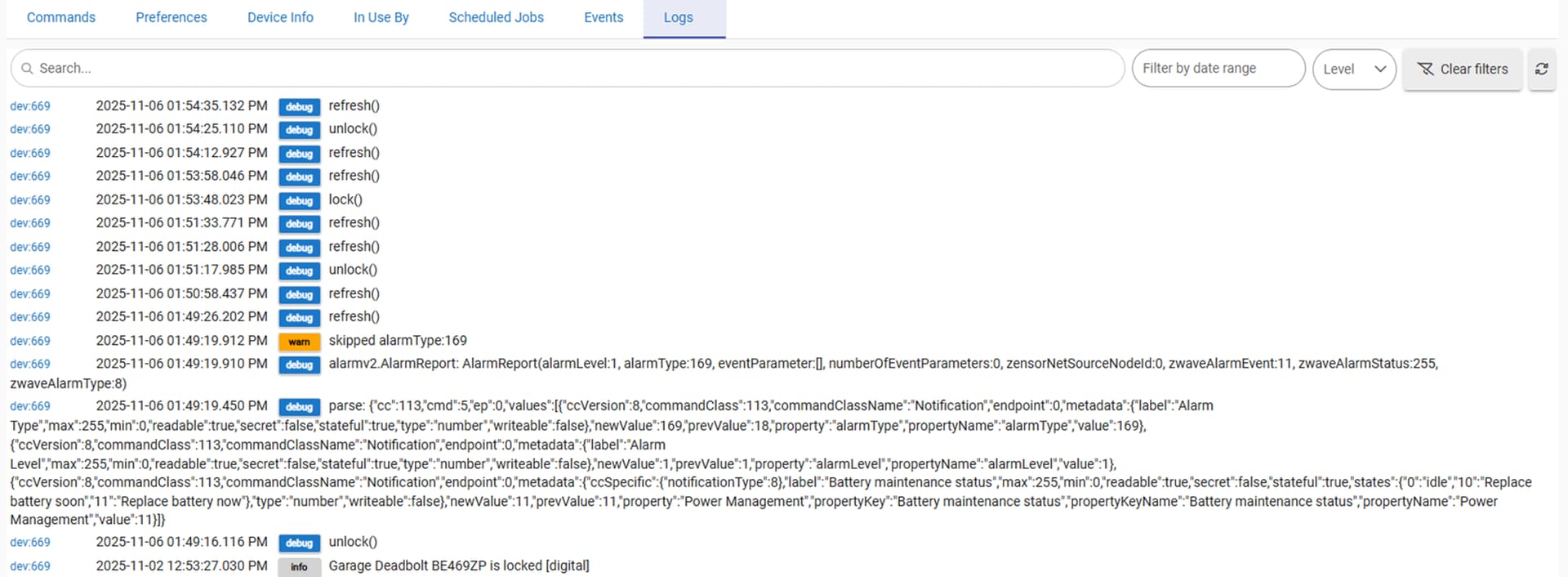

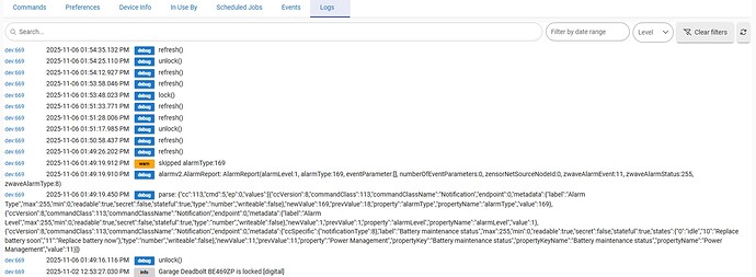

Anything jump out at anyone from the attached?
I tried locking and unlocking around 1:54PM 11/6 but no events logged and state of gui never showed any change.....
Maybe an internal hardware problem that drained my batteries in 4 days but can't tell remotely. I'm souring on Schlage pretty quickly.........
UPDATE: the 169 alarmType is batteries are critically low so must be some hardware issue draining batteries too quickly......

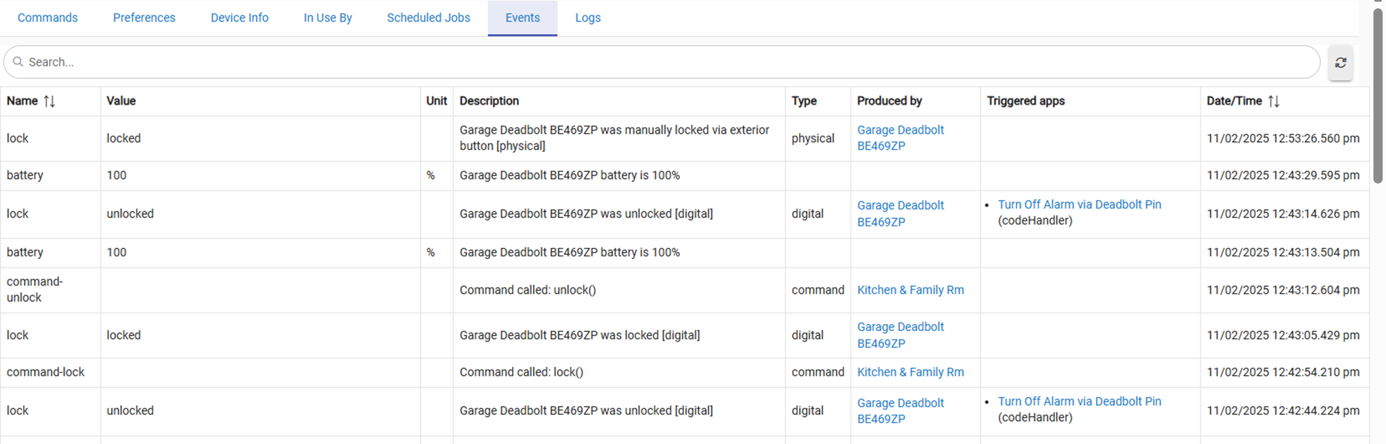

The point I was making was that new batteries were installed in the around 1PM 11/02 There are no log entries since that time until I tried an unlock on 11/6 at 1:49PM where the lock responded with a fatal battery level message before completely going off line.
Why didn't the lock report batteries low before hitting a fatally low level? I believe there are multiple steps in the battery monitoring such that a xx% fuel gauge can be show on the device template. So shouldn't the lock have reported well before 11/6 1:49PM, ..."hey my batteries are low, change them soon"...?

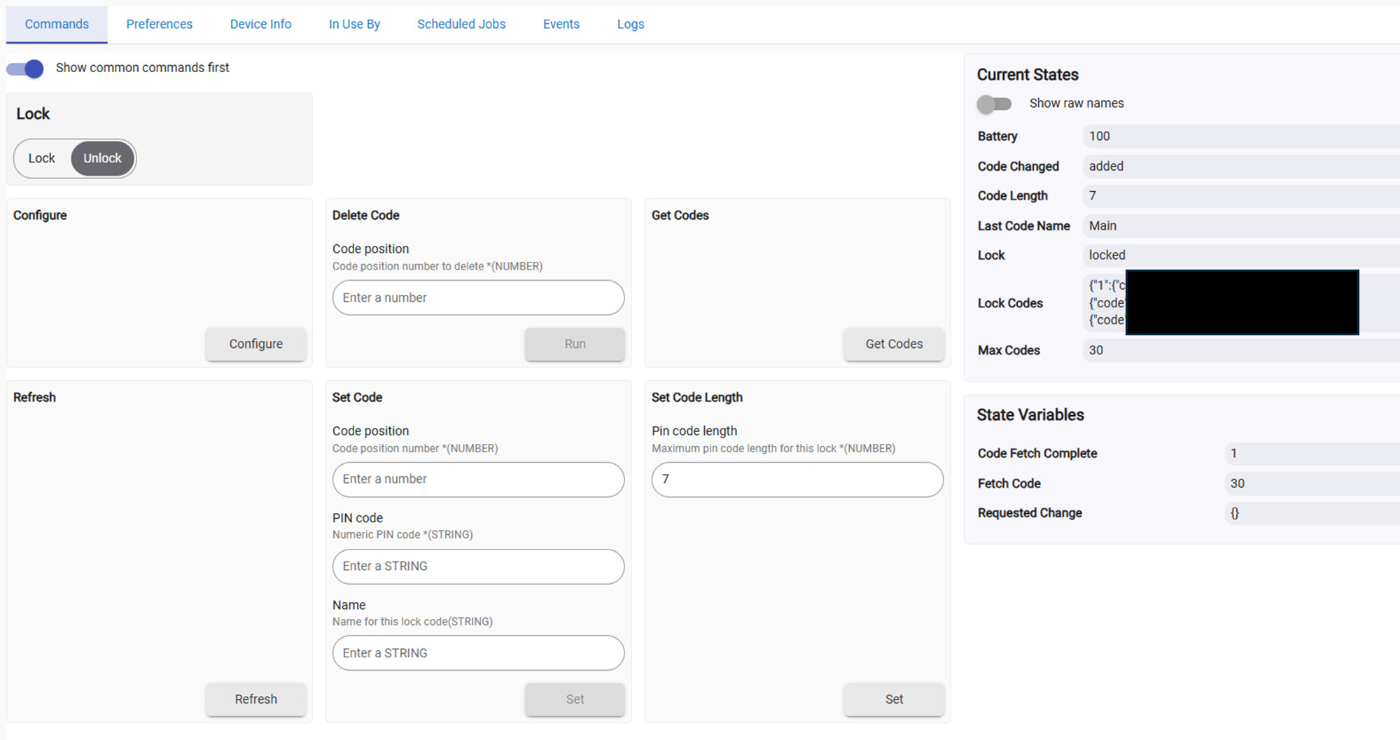

p.s. I have found the device driver (Schlage BE468/BE469 Lock) for this lock doesn't work to change the code length. It works to enter and remove codes but fails when you want to change code length. I had to change code length at the lock keypad then I could enter my 7 digit codes from Hubitat.
