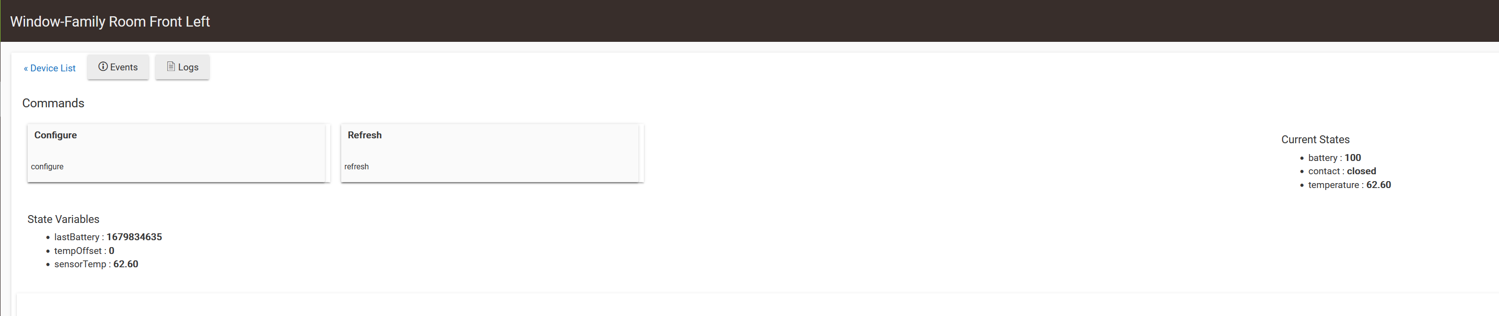

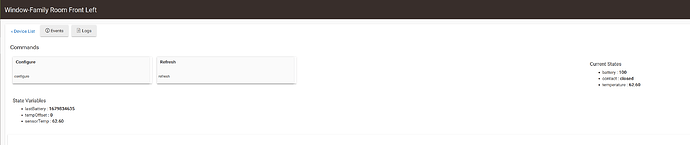

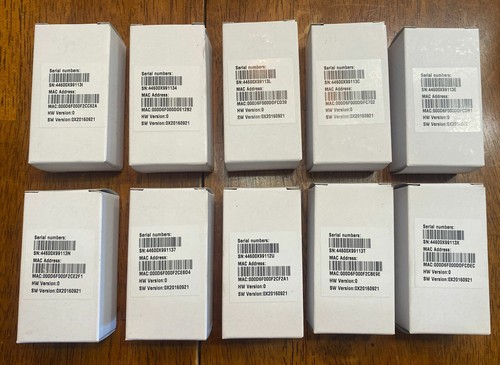

Honestly these are are great. I have 36 in use on windows (though I own a total of 40) and they have temp built in.. At 4 bux each they can't be beat.

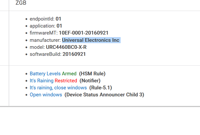

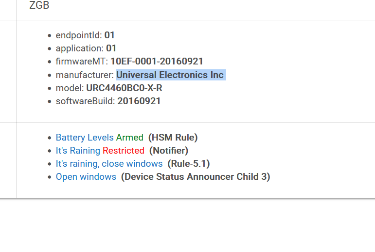

By the way, mine are EcoLink model 4655BC0-R
These are made by Universal Electronics Inc. for xfinity alarm systems. The batteries are easy to change. Just use a coin or a spudger to pop open. Actually you don't even need that.

Well I'll check back in if one dies, like I said so far it's been 8 mos and none of the 36 have dropped off the mesh (even when I migrated to the c8)
