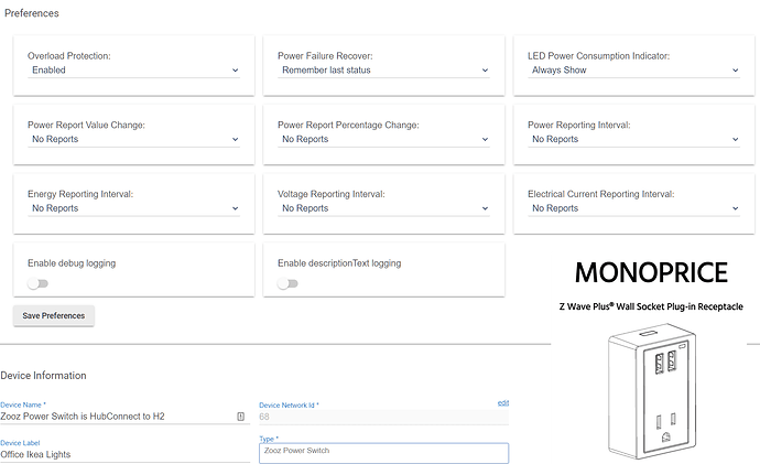

Your preferences page looks different than what I see using the built-in Zooz Power Switch. Here's what I have for those devices when I don't want any reporting.

The driver was zooZ Z-Wave SmartPlug, now I changed for Zooz Power Switch.
Now works, thaks @mpoole32 @bertabcd1234
This is still not a built-in driver (based on the name and the screenshot), and for troubleshooting custom drivers, a link to the custom driver so others can see what it is more easily is usually a good idea. I normally wouldn't recommend using a non-Generic driver that wasn't written specifically for a device, but a quick glance at both manuals suggests that the parameters for the Zooz and Monoprice line up pretty closely, despite being entirely different devices physically. So, it looks like you might be good! Glad you git the issue figured out in any case.
