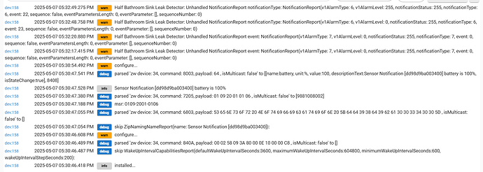

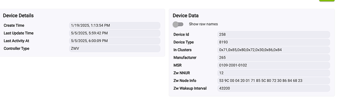

Here are screen shots of one of the working devices

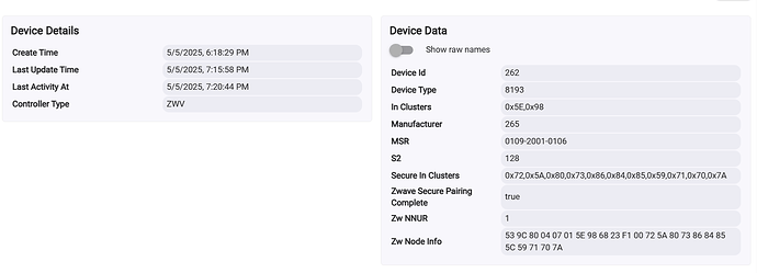

Here is one that doesn't work.
I don't remember but I may have used another driver to get the first ones working to get it configured or it may had an option in the old driver to configure it. I thought there was an advanced settings in the device info or the Preference tab of the device. There are several threads on this device in the forums. I see in the instructions to enable it is the same as this tread says Monoprice 15270 Contact Sensor - Enable External Switch?
Your working devices are paired with no security. The others are paired with security.
Exclude and re-pair with no security.
Not only that, they are different devices. Look at the device ID (the Z-Wave data in this device details table, not to be confused with anything related to the hub itself). I suspect that is the real difference. Maybe one is a newer generation and doesn't support this parameter. Do you have the manual it came with or any other matching documentation?
Sure are different - I’m embarrassed I missed that. The newer ones are zwave+, while the older ones are not.
Looking these up, I believe that guess is indeed correct: the newer (?) one just doesn't support this parameter.
Here is some information on both:

I confirmed that the working ones are all 258 and the non working ones are 262. They are all the same model number from monoprice 3 of 4 that are working were once connected to my old vera 3. They could be slight different since I didn't buy them all from monoprice at the same time.
I tried re-adding without encryption but it keeps adding it with. I don't see an option to disable/turn it off. Is that setting buried in the web gui? When it adds with encryption I don't have to add any pin like I do with other S2 devices.
The ones you have that were added with security show "S2: 128" in that table, which means S0. On the traditional hub Z-Wave software, you won't get an option to choose security or not if a device supports only S0 and does not offer separate secure and non-secure inclusion modes on the device (from memory, this one does not). If you have a C-8 Pro and have upgraded to Z-Wave JS, you should get that option during inclusion like you do for S2 devices on any hub that supports S2.
But I wouldn't worry about it; S0 is good to avoid when you can, but in your situation, aside from the above, you can't, and a contact sensor isn't likely to be chatty enough to matter. It also won't change the behavior you see, as this configuration parameter does not depend on security (nor do most).

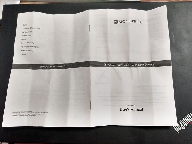

I got the manuals here. I guess they are different kinda crazy that I used the 4 10795's first then tried to install the 15270's 4 months later.
10795 (258) Instructions
15270 (262) Instructions

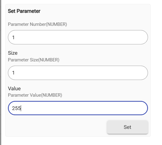

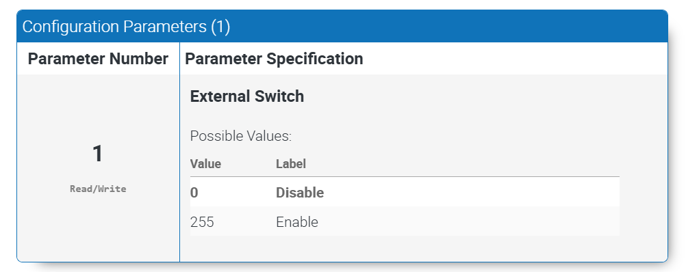

So from the instructions it looks like I need to set this.

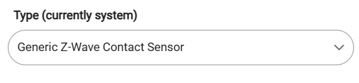

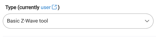

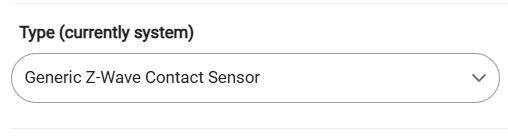

I have tried changing to this driver that I manually added.
And setting this.

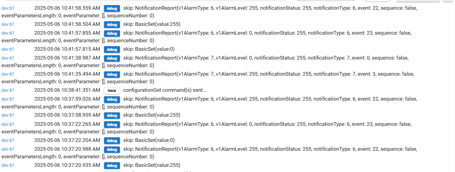

Then I try and wake up the device by opening it up setting off the tamper alert. But it does not appear to work. Any suggestions or another tool that works better.
Here are the logs after sending the command.
Assuming you have the right model, that should work,,but you need to wake the device basically at the same time you send the command, or really a second or so before so it's still awake when it's actually sent.
I'd also try the "Get Parameter" command for parameter 1 when you're done to make sure it changed. You should see something in Logs. It will also need to be awake for that.
Sorry did not read everything in here but I made this custom driver for someone a while back, I think it was for some sort of Monoprice Tilt/Contact sensor also with external contacts.
That device was sending different reports for the external contact so I had it pick those up and post it to a different attribute. So just sharing this in case it is useful. Could also be modified to work for your device if the system driver is not working.

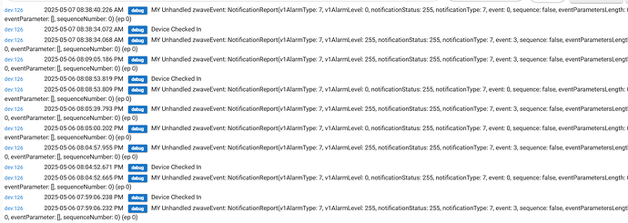

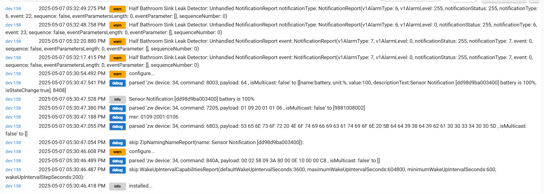

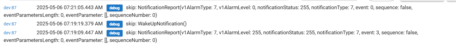

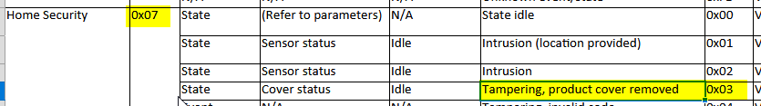

Not sure if I am doing this right. Here is some logs trying to get the 1 parameter and then set it.
Does this mean it was set correctly? skip: BasicSet(value:255)
None of those logs are related to changing parameters except the one info log just showing it was sent. The settings changes will be configuration reports.
You will need to wake the device and then send the parameter a few seconds later. I think when you wake the device you should see some sort of debug log about a wake up.
I think I was able to set it but now it doesn't alert for either the main sensor or the secondary. I used this driver
SmartThings/devicetypes/krlaframboise/monoprice-zwave-plus-door-window-sensor.src/monoprice-zwave-plus-door-window-sensor.groovy at master Ā· krlaframboise/SmartThings Ā· GitHub and swapped out "physicalgraph" to "hubitat"
I am about to just solder the leads of the other sensor into each side of the magnet sensor.

Can you please post a screenshot of the logs so that can make sense out of it. Can probably tweak my other driver to work for it.
Currently with the Monoprice 15270 Driver from SmartThings I am not getting any logs when touching either contacts but I think that is due to the driver. I was looking at yours to see if I can fix that but Haven't gotten to far yet. I added MY to the debug to tell where it was getting it from the code. I believe those notifications are all tamper related.
Correct those are tamper and idle (tamper clear) events.
If you change to the driver just named "Device" it should log all incoming messages.
Or you could also my my driver above, enable trace logging (uncomment at very bottom of code) along with debug should also log every incoming message.
I had to exclude and re-add it. I used your driver. I first 2 are the tamper on off and the last 2 are the sensor closed then open.
I only tried once from your driver to set the external sensor but I don't think I got it to take.
Try this driver updated same link as above:
Hubitat Generic Z-Wave Tilt/Contact Sensor Ā· GitHub
It should automatically set that parameter 1 to 255 when the device wakes up.
It should pick up the events you posted above also, for tamper and the contact open/close.
