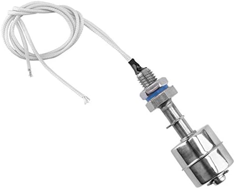

I use a Float Switch and an Ecolink Door Sensor.
The Float Switch is mounted to the lid of a waterproof container and then wired to the internal contacts of the door sensor. The Float Switch is just a magnet on a shaft, with a reed switch inside. You can invert the magnet float and change normally open to normally closed.
The entire assembly is then mounted to the underside of the skimmer cover.

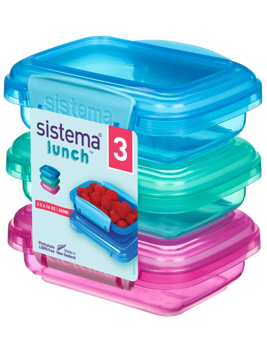

Curious what water tight box you’re using and how you’re attaching to your skimmer lid if you could share that info. I assume you’re just monitoring if it’s too full vs needs more water? Guess you’d need two at different lengths to do both. Thanks!
Just a sandwich box really
Part of a set. I think it's the 300ml one, quite small... 4.5 x 3.5 x 1.5 -- I picked it because it has a real o-ring like seal in the lid. Probably got it as a set from Target.
I began with using tie-wraps through the finger holes just to verify it would work. It's out in the middle of the yard, so not exactly the best mesh ![]()
I found it was pretty darn close to the right placement for the high/fill water level. I ended up needing to offset it from the skimmer lid by about a quarter inch. (Adding space between the inside of the skimmer lid and the container pushes the level sensor towards the water surface. I had some spare pieces of acrylic from building the Pool controller and just glued it up. Replaced the tie-wraps with some stainless steel screws and nuts and they go through the skimmer lid and through the spacer with double nuts that allow very fine adjustment of the height... which I don't actually need.

Old thread but i have a question please. When i try that link i get routed to a 110v water level sensor. Do you happen to have a model number for the low voltage one you used?
Thanks. Mac.
That's the one I'm using.
It's just a reed switch inside the long tube with a magnet inside the float.
The reed switch can handle all voltages up to 120v. Including the 3v used via the Contact Sensor.
Thanks. I think I can use that on a zen 16 for triggering the valve to open or close off the switch input. Seems easy enough and mains powered off 24 volts.
