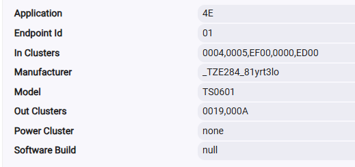

I'm using @kkossev's Tuya Zigbee Metering Plug driver for my Tuya Zigbee power meter with clamp.

Good point. Technically my device can monitor two circuits, but your driver only monitors one channel.
I poked at AI to get the other channel working when I first got it, without much success. Good reminder to try that again, though. I don't think I was patient enough with AI the first time.
