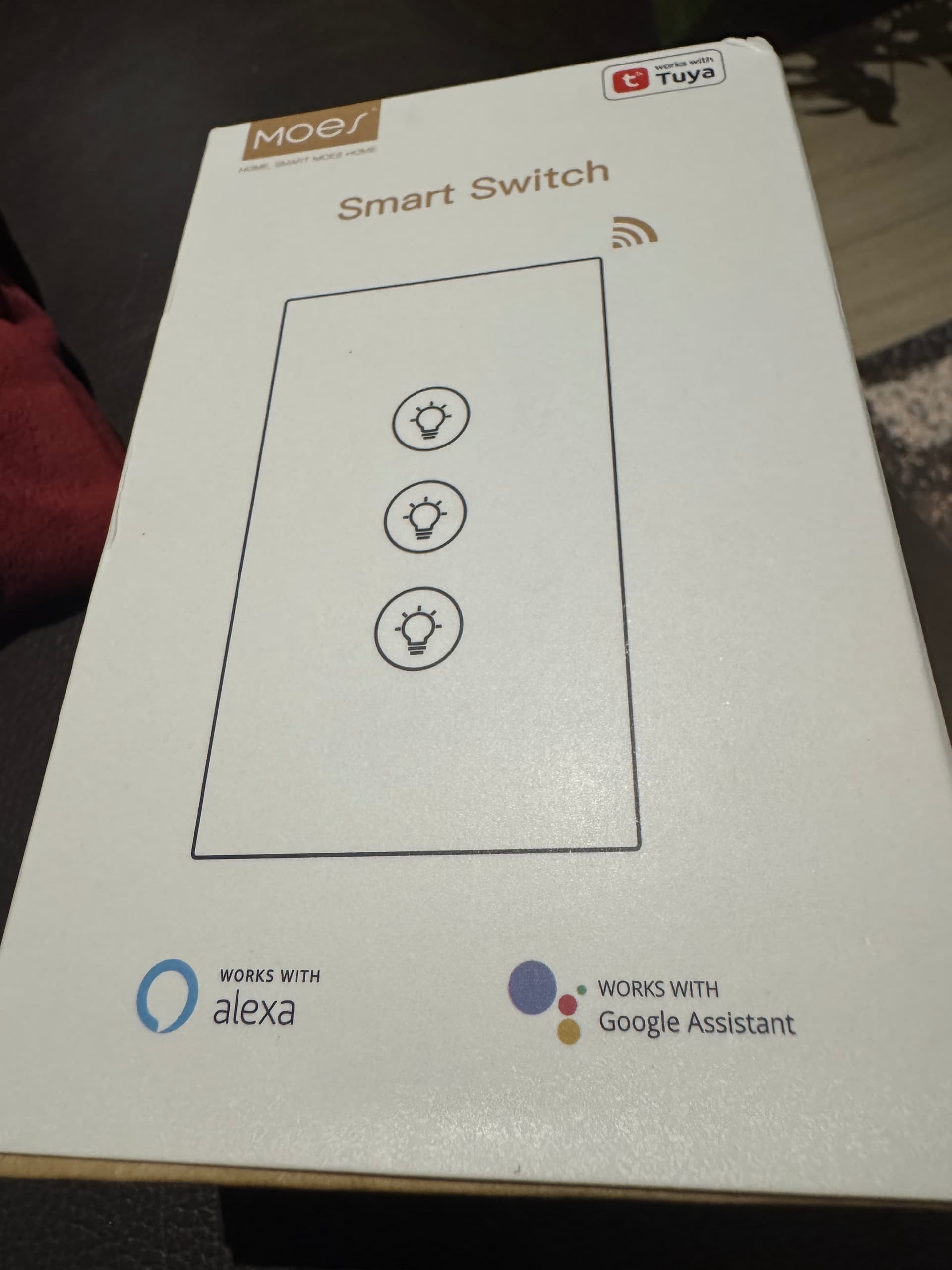

I've purchased three of these touch dimmers but none of the suggested drivers work. The main problem is the drivers do not create the child devices to control the three gangs.
I've tested the Moes dimmer driver, the Tuya driver and many others.
Can you help me? I spent much money on these devices!!! Maybe someone can modify one of the drivers and make it work!
This is the Data of my devices, and I am attaching the picture of the device's box
