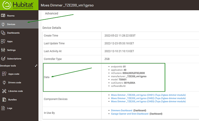

All Zigbee devices are identified by their model and manufacturer, as shown in the device page 'Data' section when paired to Hubitat.
It should look like this:
endpointId: 01
application: 40
inClusters: 0004,0005,EF00,0000
manufacturer: _TZE200_vm1gyrso
model: TS0601
outClusters: 0019,000A
softwareBuild:
Please copy and paste your device's data and we should be able to find a driver that works then.
The 'Data' section is located at the bottom of the device web page :
