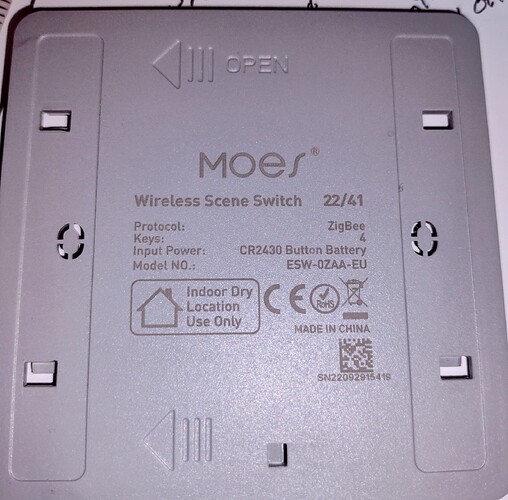

Does this help?
No, what is printed on the plastic does not help...

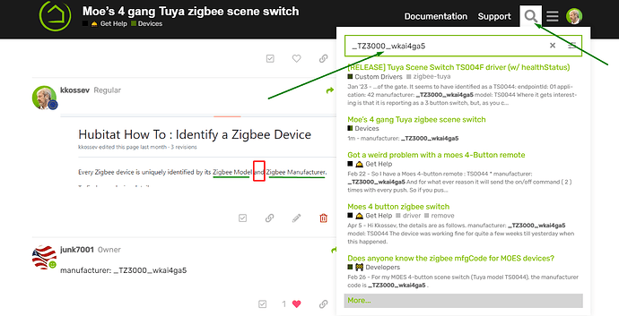

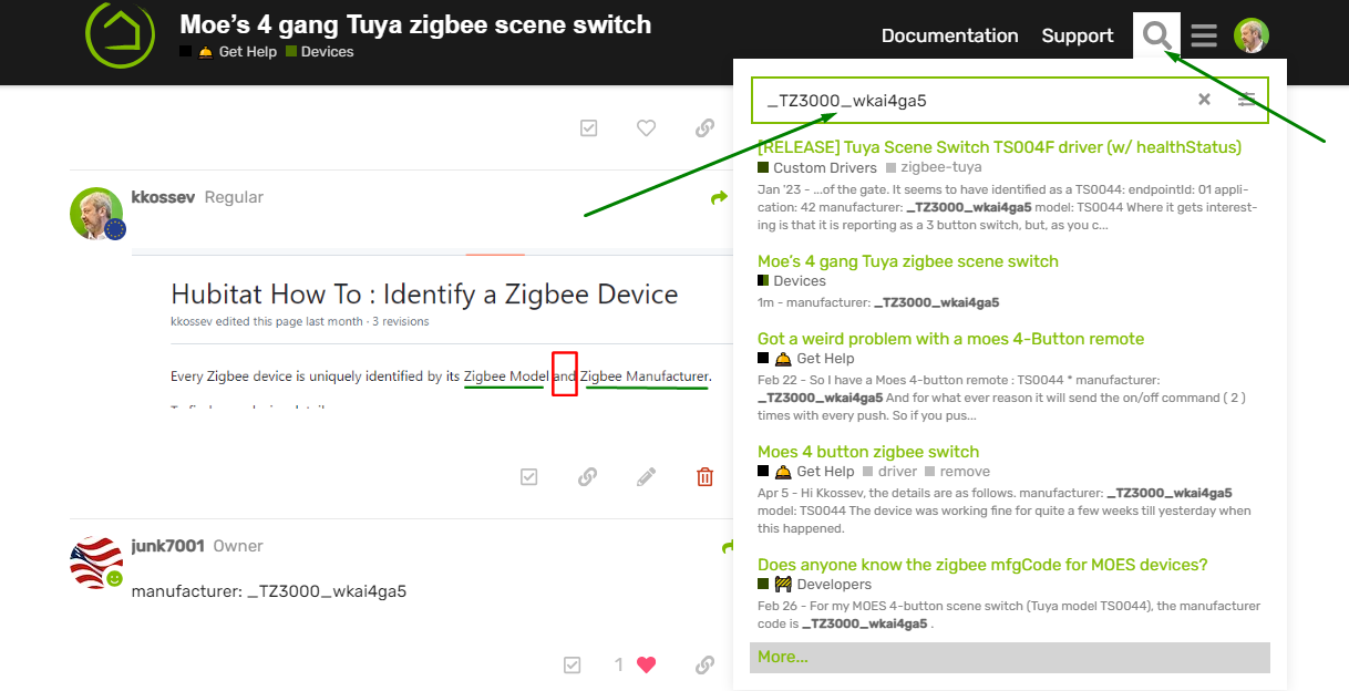

My previous post contains a link to the instructions on how to identify a Zigbee device.
model: TS0044
manufacturer: _TZ3000_wkai4ga5
I need to improve the instructions and add what could be the next step, after identifying the device...
Hubitat forum contains a lot of valuable information..
Shortly - select the device manufacturer ID, copy it and paste it in the Hubitat forum search control.
In many cases, there will be enough information for this particular device, that can help to resolve the issue.
