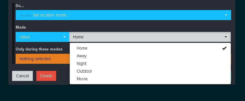

I am trying to change modes via Piston, but I can't get webCoRE to recognize updated modes. I have reset the hub a few times now.

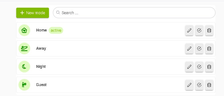

These are the existings modes:
webCoRE is still seeing the old modes:
I noticed when I added a few new modes in WC a few months ago they did not immediately show up unlike Device adds.
They did eventually show up 5-10 minutes later after a few logouts from WC.
Didn't really notice any special solution but I did notice the lag.
Logging out of / into webCoRE solved it. I thought rebooting the hub would effectively do the same thing, but I guess not.
