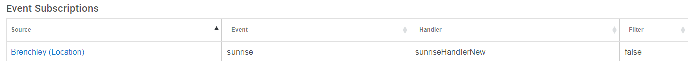

Please show the App Status page of the Mode Manager (gear icon). You should see an Event Subscription for 'sunrise'. You would only see a Scheduled Job for it during the one hour after sunrise.

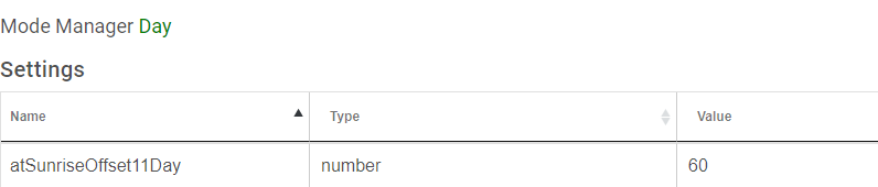

Hi Bruce. Okay, I've amended to include the 60 min delay again and I have a Job atSunriseOffset11Day Value 60. I didn't check this before so will leave it and update this thread tomorrow. Thanks for the response.

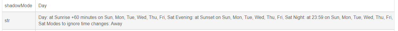

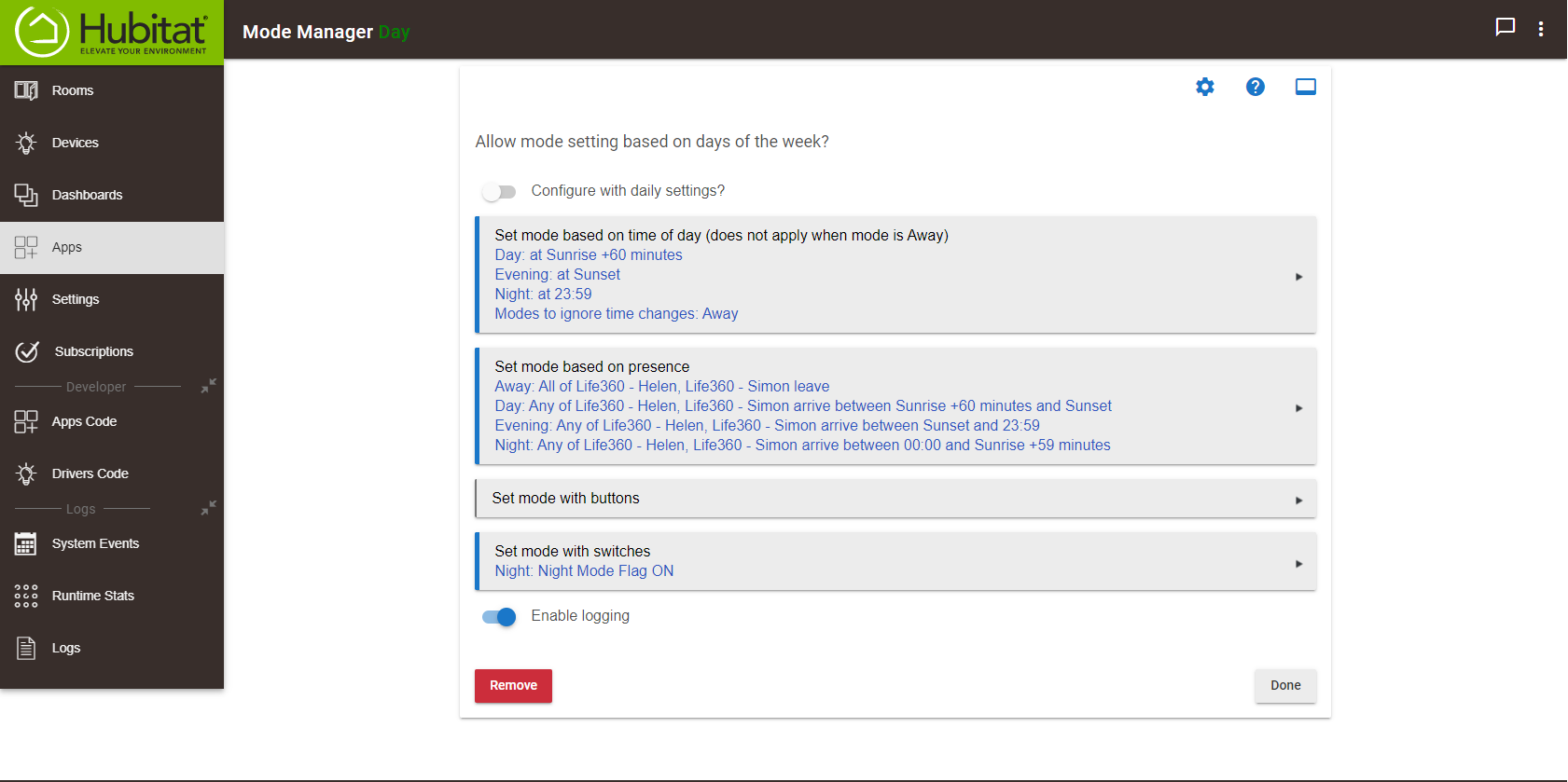

Please remove and recreate your Mode Manager instance. Then, show it here in a screenshot.
Removed and re-added. Screen shot attached.
Edit: Corrected mistake made based on presence Day
@bravenel All working great now thanks.
