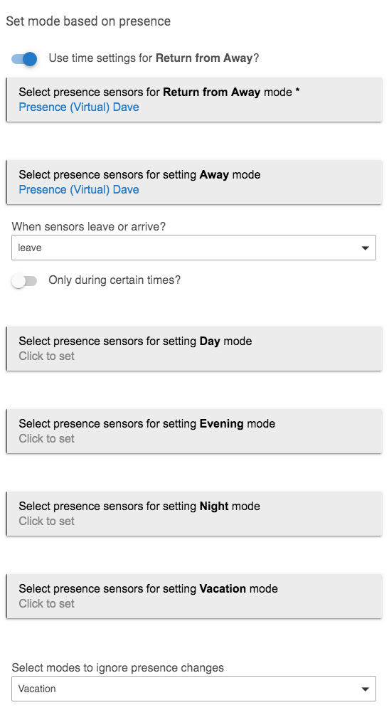

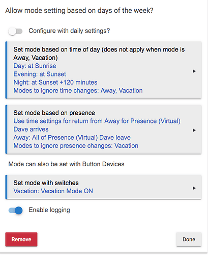

I have the Mode Manager app installed and running on my hub with these settings:
It seems to work fine for most of the modes, including switching to "Away" when my Virtual presense sensor leaves the house. But when I return, Mode Manager doesn't switch back to Day/Evening/Night when I return. It just stays at "Away". Shouldn't Mode Manager set the mode to "Day" after I return from away between Sunrise and Sunset (like I have it configured)?

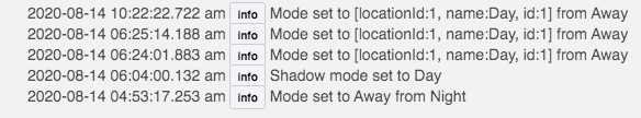

Here's my log file for Mode Manager:
Screen Shot 2020-08-14 at 11.39.10 AM
It shows Mode set to [location:1,name:Day,id:1] from Away which seems ok, but the mode really didn't change from Away.

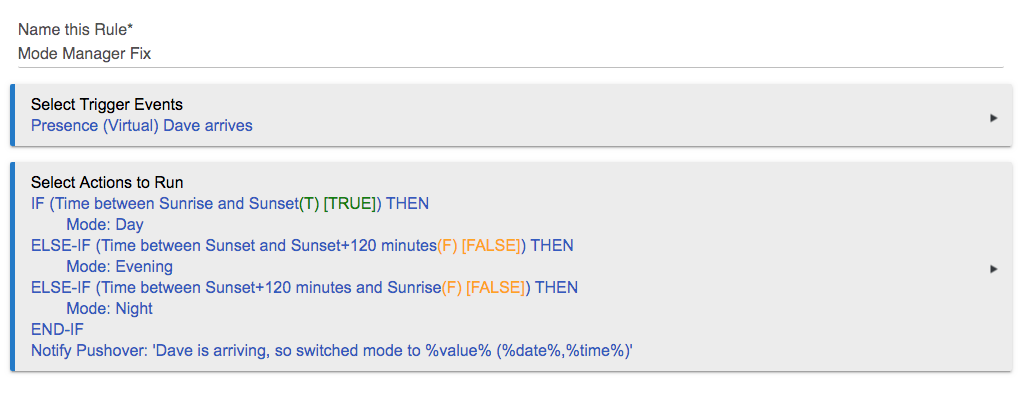

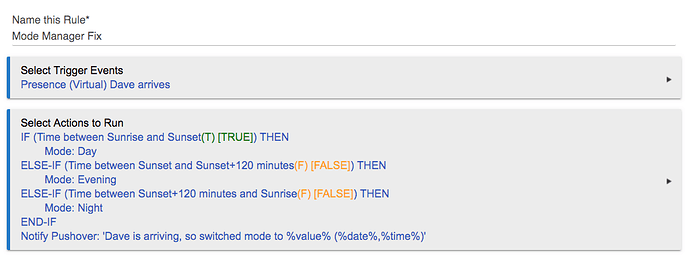

I've written a simple rule for RM which sets the proper mode when I return from AWAY,
This appears to fix my problem, however, it's strange that Mode Manager can't make this adjustment with it's coding.

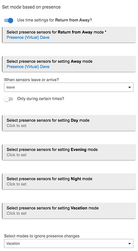

Thanks for your suggestion. Are you talking about these settings below:
This is what I have currently. Are you suggesting I include my presence sensor in the Day/Evening/Night settings for arriving? My understanding is that if I did that, the mode would try to switch to one of those settings when I arrive regardless of the current time.
yes. Your presence isn't triggering because sunrise is your day trigger. So I think you would need to have a trigger for your arrival. If you worry about false positives, there are apps out there that rely on more than one presence trigger to determine if you're home or away. I had my modes set up long before mode manager was a thought, so mine run in rule machine and i can define the conditions to keep the modes in correct order with everything considered.

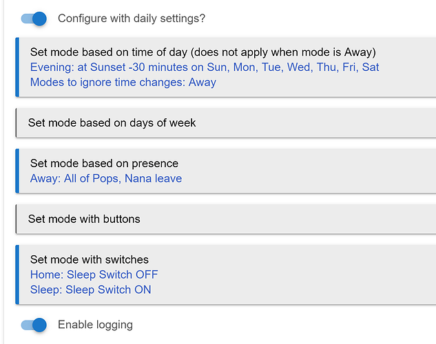

I could use some help here as well, having a similar issue where mode is set to Home when returning from away when it should be Evening
I.e. Mode is Evening, we both leave, when we return, Mode is set to Home when it should be Evening
Thoughts?
Edit: I initially had Use Time Settings for return from away and it wasn't working, turned it off and when it still wasn't working, I posted here, now I turned it back on and now it's working... go figure
