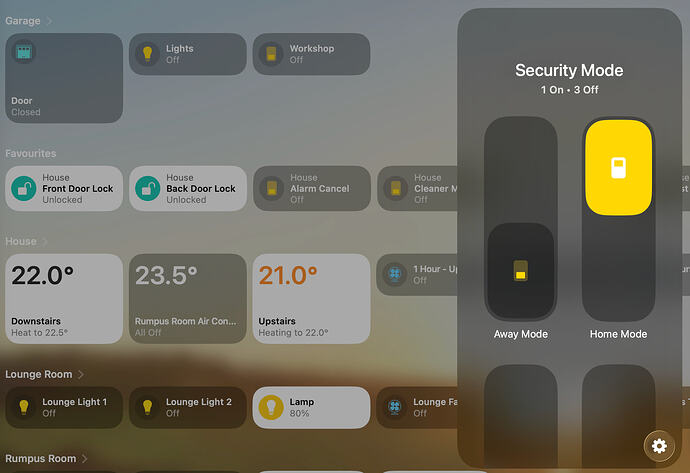

If I manually change the mode via Apple HomeKit (HE integration), it works as it should.

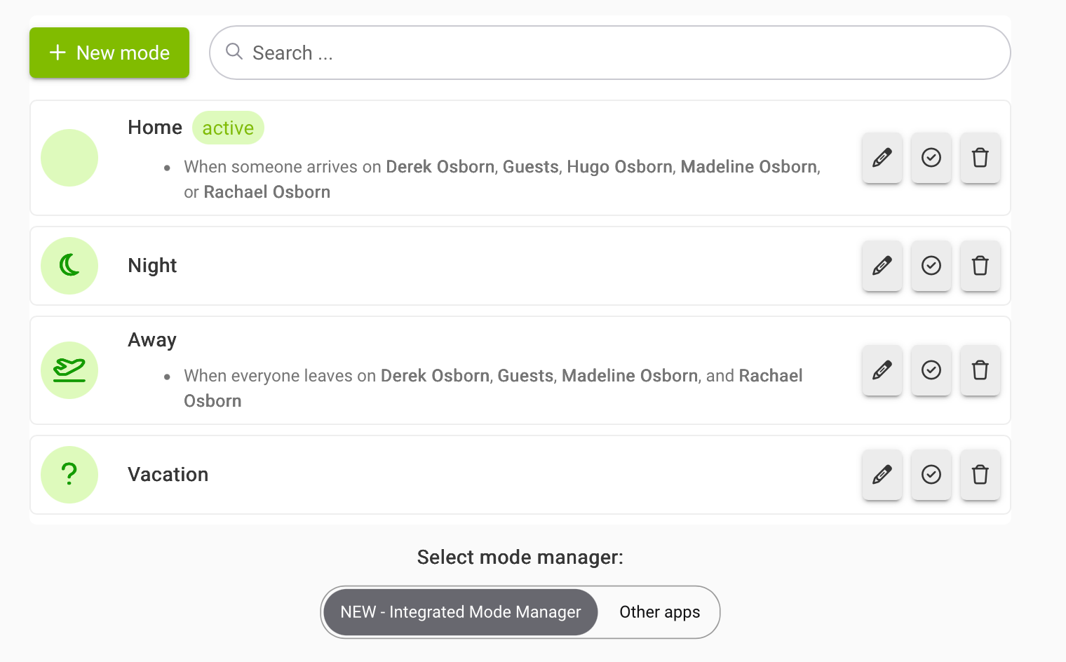

My Home / Away config is dead simple.

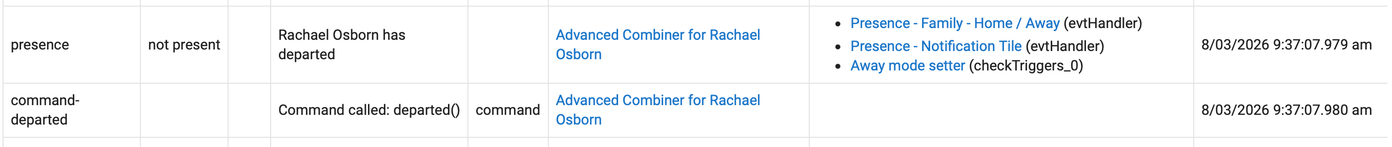

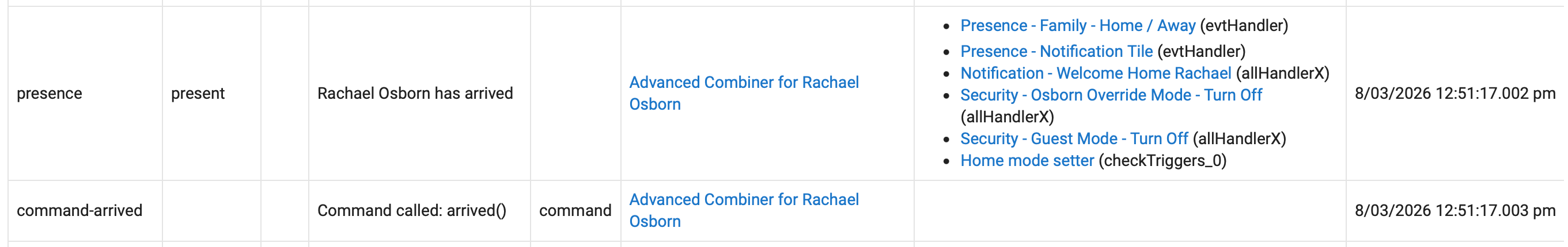

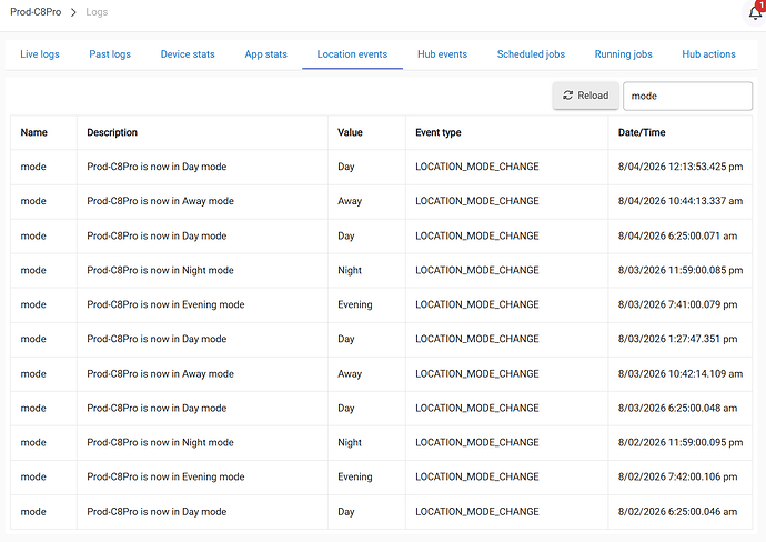

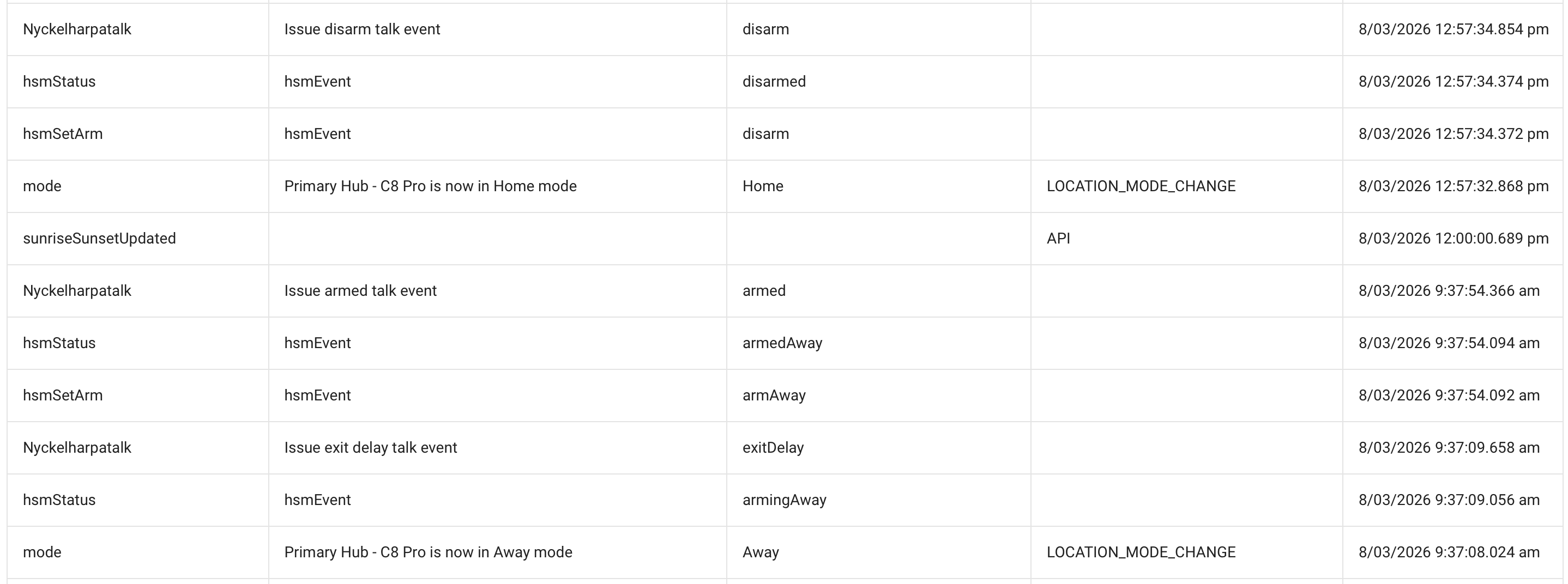

eg yesterday arvo my wife came home and the house stayed in Away mode:
I ended up manually turning on Home mode remotely for her (Why do wives never listen to instructions!). You can see that it did automatically go into away mode when she went out at 09:37 without issue.

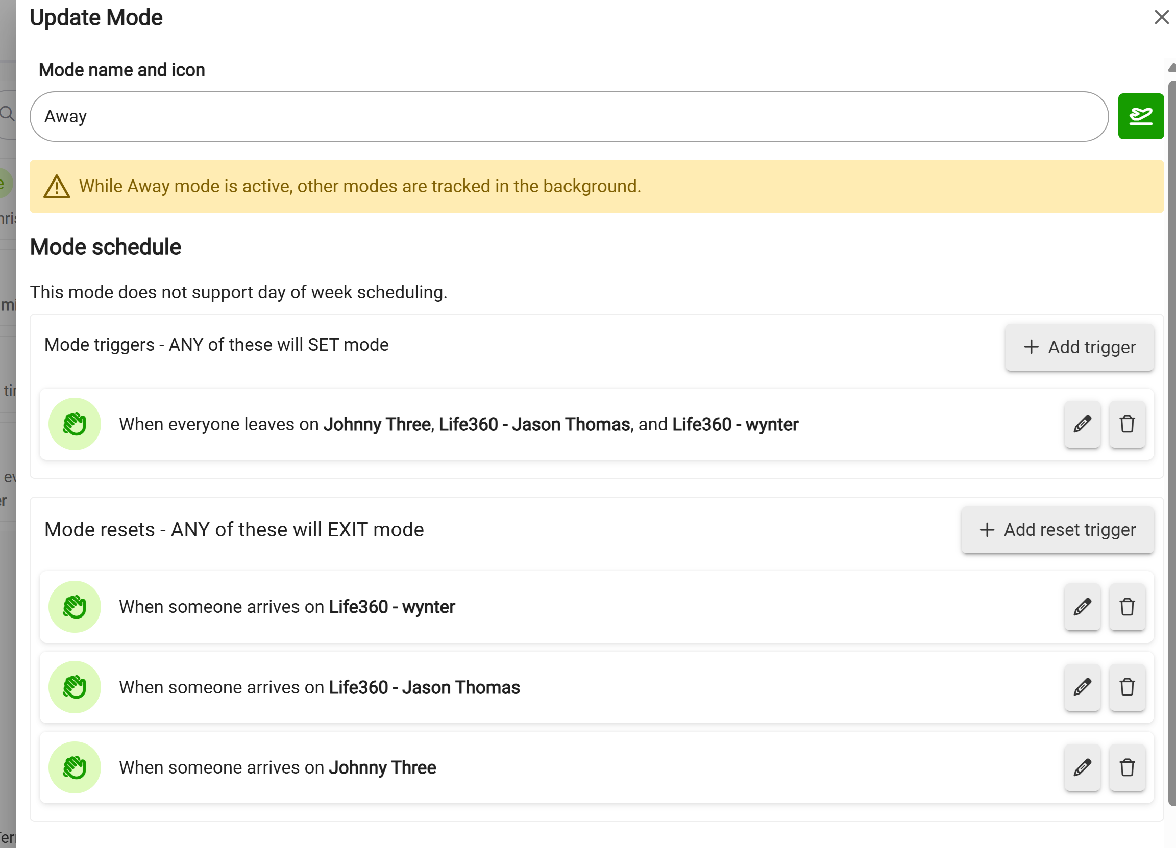

Honestly, Mode: Away " Return" has been hit or miss for me for a long time, regardless of which version I've used.
IF you have an arrival rule, which most of us do, add the mode to the arrival rule.

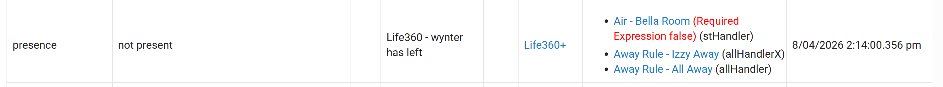

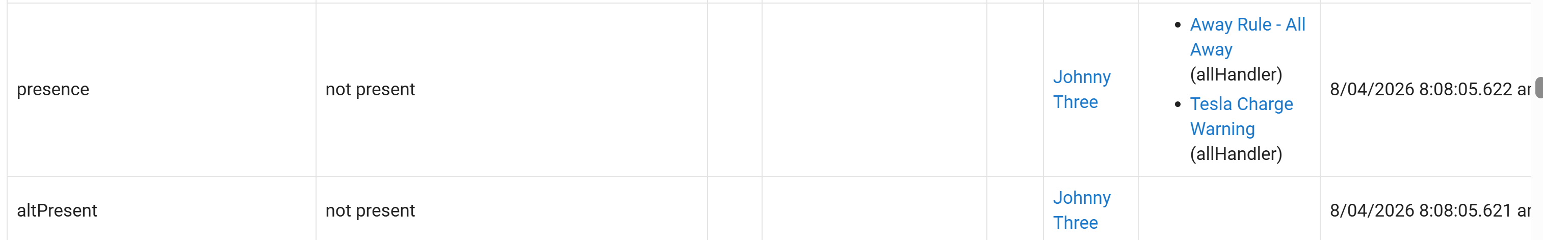

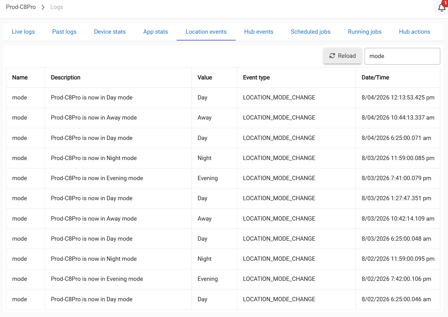

Edit: Based on today i checked logs on all three. (Away never triggered)
Its normally the return that does not.

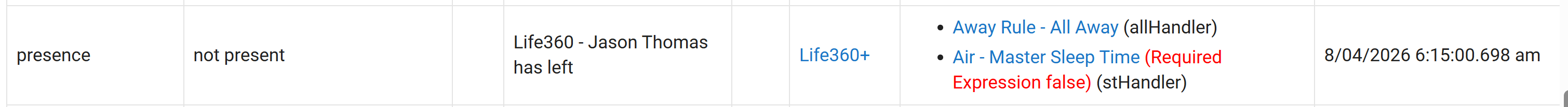

1- I left at 6:15AM
2- Johnny Three left at 8:08AM
3- Wynter Left at 2:14PM
None were present when all three were away.

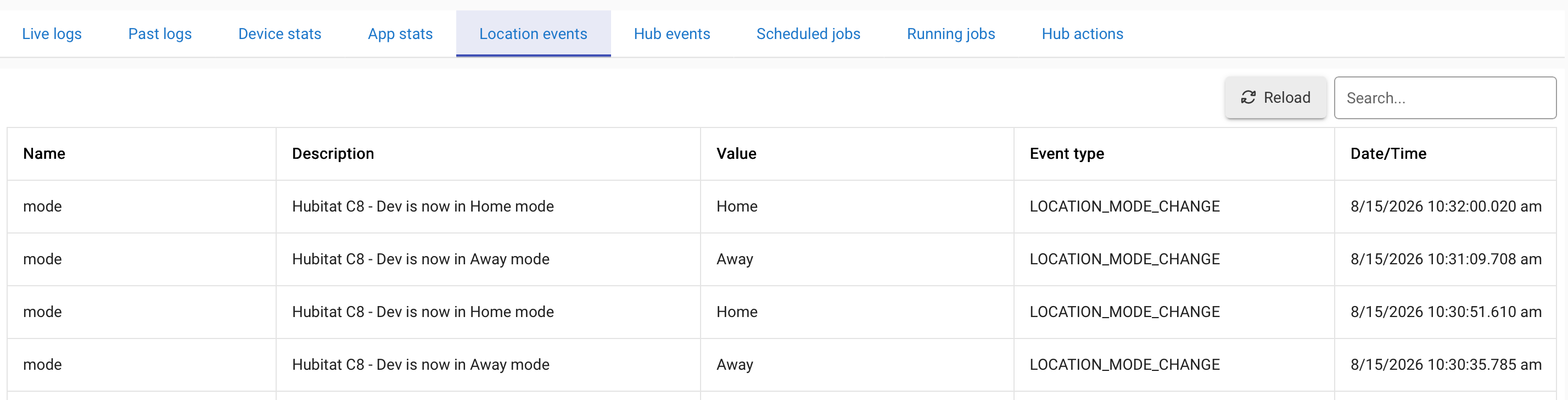

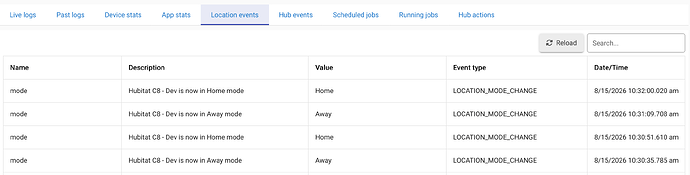

Last Location event:

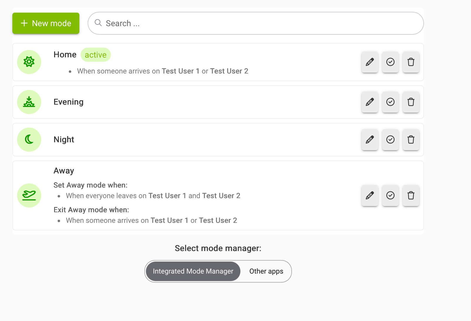

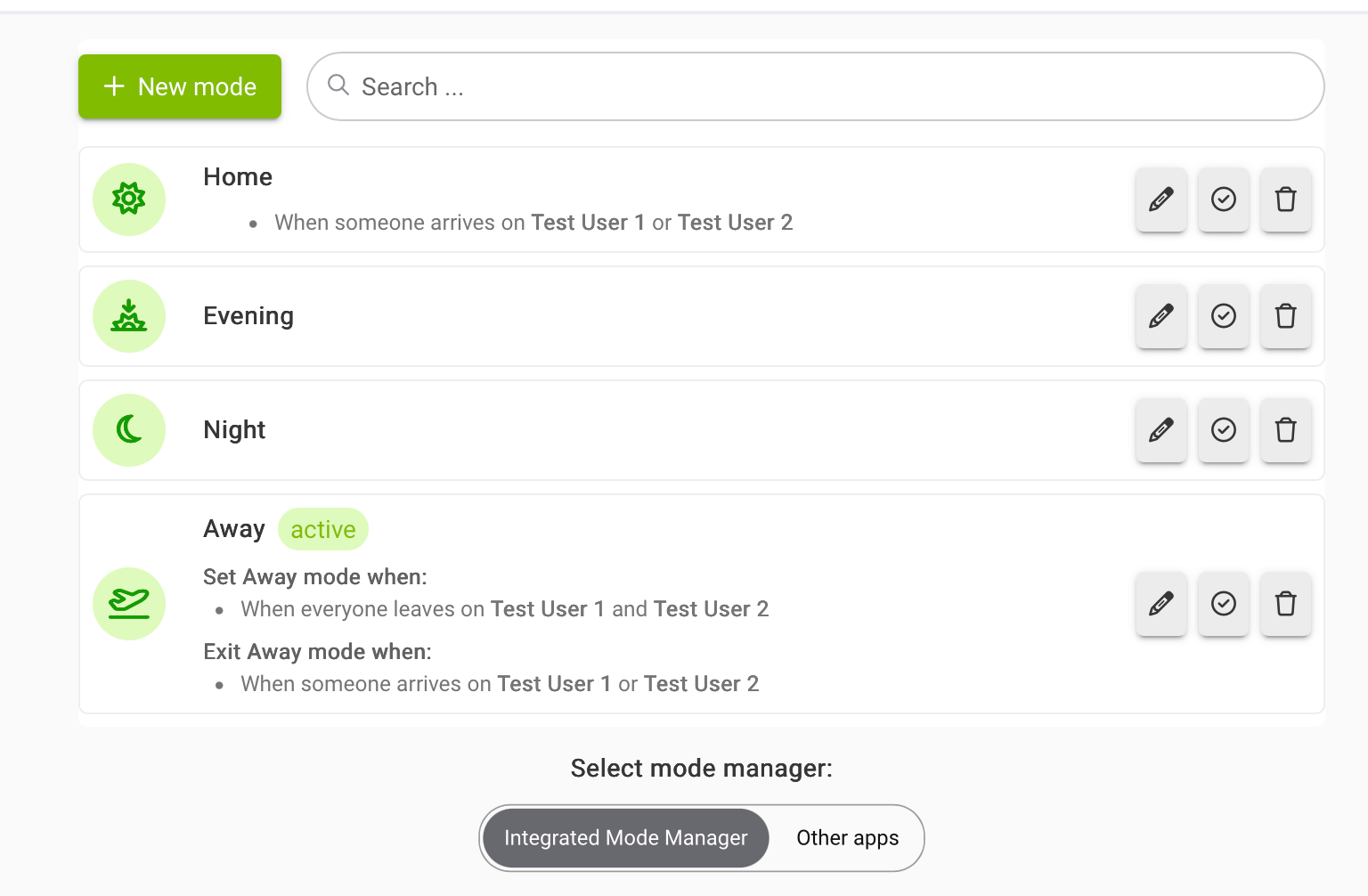

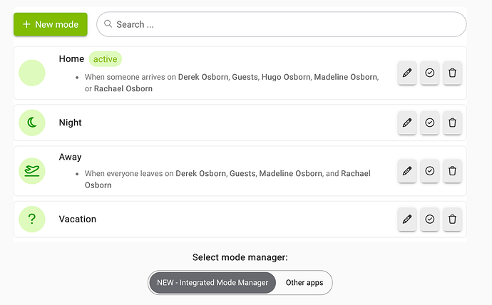

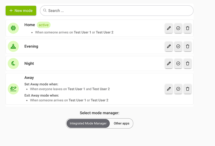

How its set up in New Integrated Mode manager:
