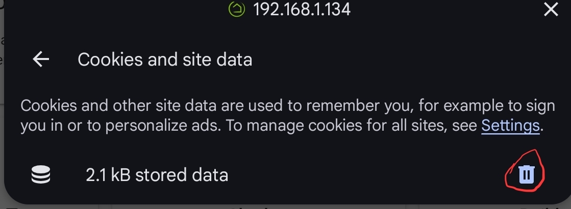

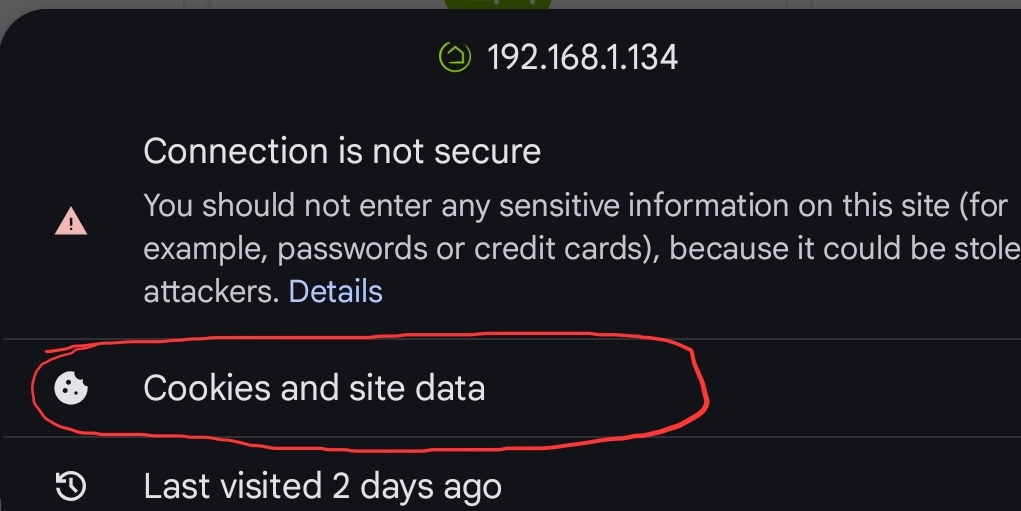

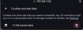

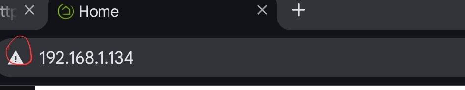

The only other thing I can think is to go to the IP address in the browser, let it show the grey page, and then clear the cookies and data for the site.
