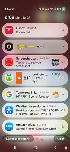

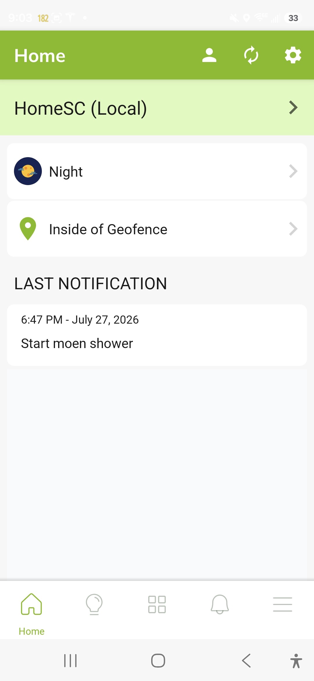

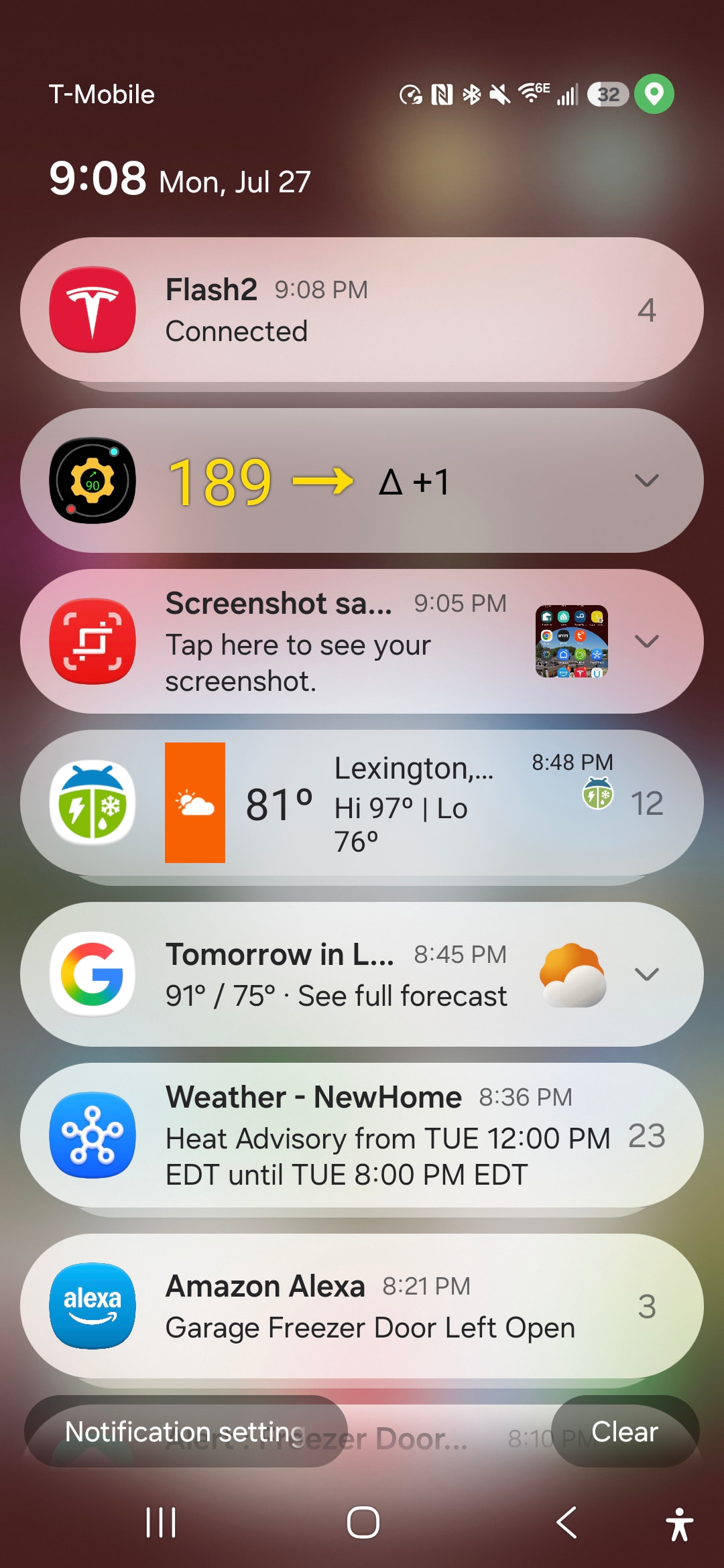

Hi, I seem to be having problems.Solving my basic need, which is to send notifications from Hubitat to other apps on my phone. I have an Andoid routine on my phone that needs to be triggered by a specific notification from HE. But the HE notications seem to never reach my phone Gallaxy S26+.
Notification produced by NTFY driver:
Never got to phone Notifications. I have enabled ALL permissions

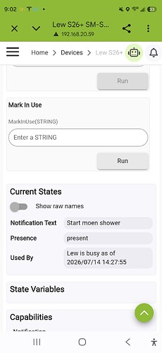

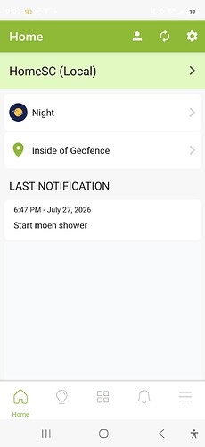

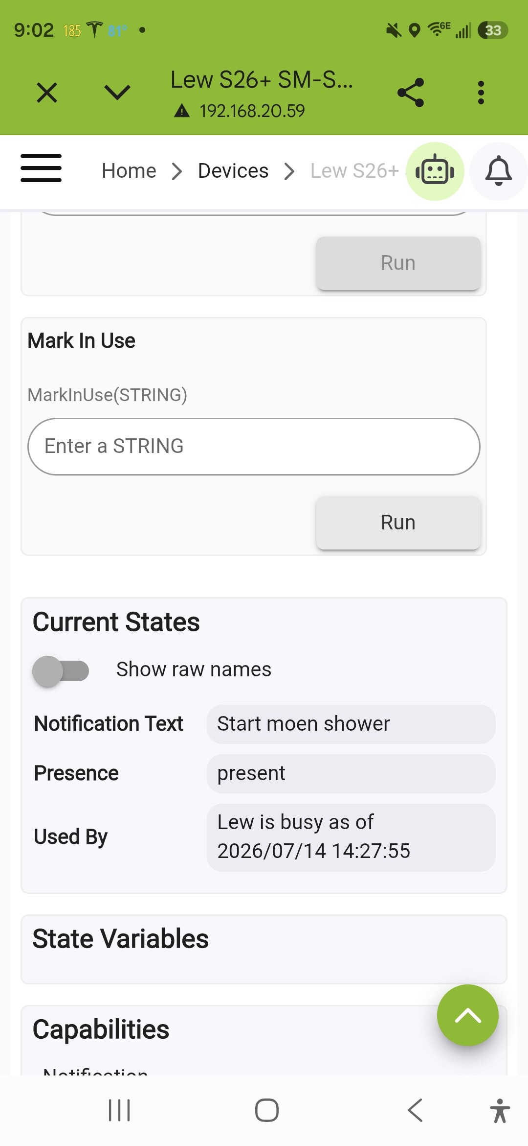

The Hubitat phone driver got the notification
So, why don't they go to my phone notifications

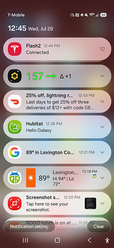

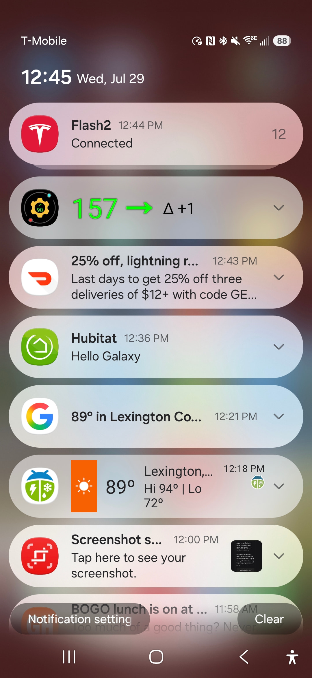

That works! Thanks
