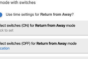

In the page for "Set mode with switches", use the switch that ends Vacation Mode to "Use Time settings to Return from Away" (you have to turn on that option). That will set the mode based on what time it is when that switch turns off, even though you aren't actually coming from Away mode. On the page for "Set mode based on time of day" add Vacation mode at the bottom for "Select modes to ignore time changes".

But is this what your saying.?.. Then when Vacation Switch goes Off, We will 'Return from Away' which will then set mode based on the Time of Day settings... (I do have it set to ignore Vacation mode for time changes)
Yes, using Vacation switch in both places:
Set Vacation mode with this switch ON
and
Select switches (OFF) for Return from Away mode
And be sure that Vacation is selected on Time page to be ignored.
