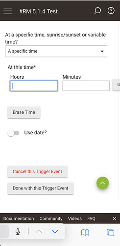

In RM, when I use time as a rule trigger, the time picker screens, both the analog and digital time pickers, are missing the OK and Cancel buttons. Therefore, I can't specify a time. Annoying but not a show stopper since I can use the PC app.
Is this just me or a bug specific to my phone?
I've attached screenshots (I hope).
Does anyone have comments or suggestions?
Thanks

SOLVED: or at least understood.
When I connect my hub for management services such as RM management, I'm actually working in a web browser (it is sometimes easy to forget that fact). By default I use DuckDuckGo and that's where the problem happened. It occurred to me to try a different browser, in this case MS Edge, and everything worked correctly with the date picker.
The obvious conclusion is that browsers matter. Mainstream browsers like Edge, Chrome and Firefox probably all work fine, but niche browsers such as the privacy-centric DuckDuckGo did not - a good thing to always keep in mind...
