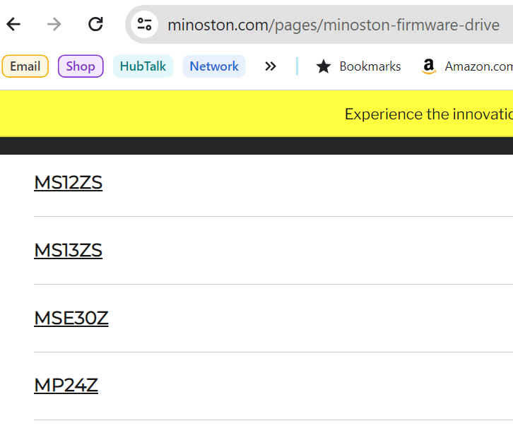

Are you getting individual outlet control of the Minoston double-plug outlet w/the Zooz driver?
And did you find/try this Hubitat driver from Minoston? In code says "ZW97" but connected to the MP24Z download link:
