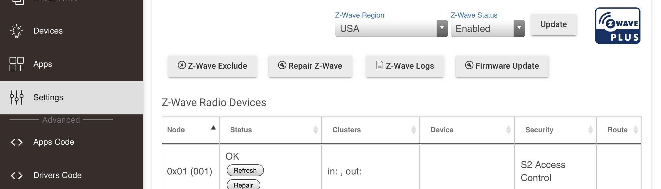

I just took my MIMO2+ off of ST as their device handler no longer works and included it in my C7 running 2.2.4.158. It is an important application for me that remotely controls my main water valve and water drain system for a second home up in snow country.
I am able to manually control Relay 1 & 2 just fine in the child apps, but changes Sig1 and Sig2 do not trigger changes in the contact field in the child apps.
It included automatically with S0 security. I don't know how to include it without security in 2.2.4.158 to see if this is causing the issue so if anyone knows how to do that let me know.
If @mike.maxwell or anyone else can help it is appreciated.
