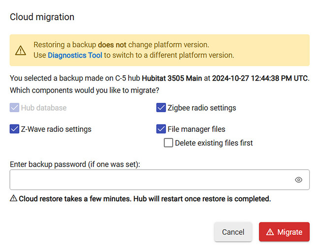

I am using the Migration Tool which creates a Cloud backup from the C5 and then should migrate to the C8-Pro. It pulls all the devices over. However, none of the Z-wave devices work.

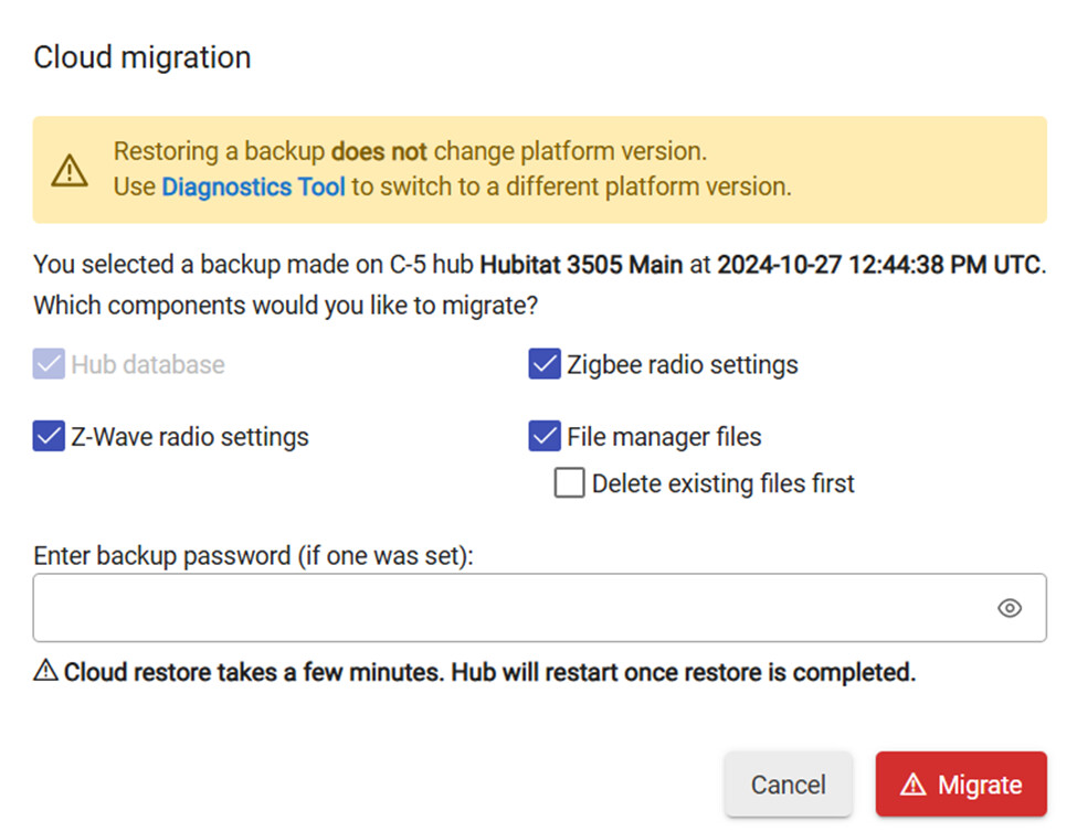

When you were doing the restore did you check both radios?

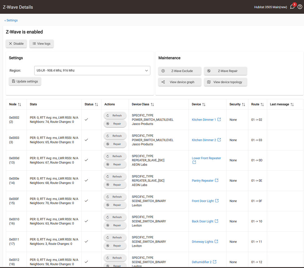

Do you have devices listed on the z-wave details page, or is it blank?

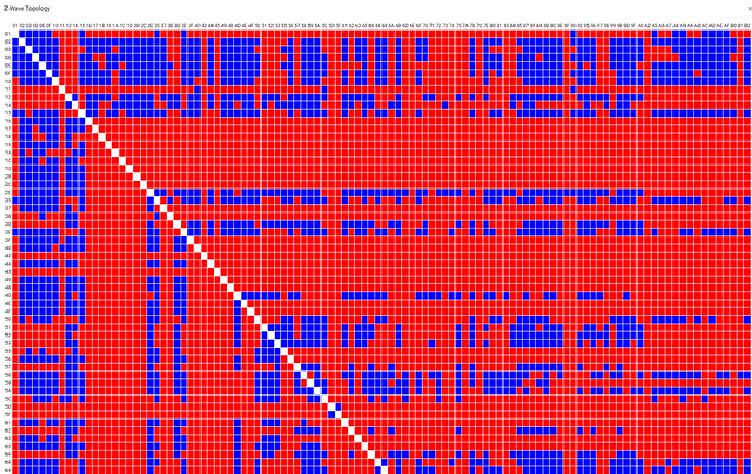

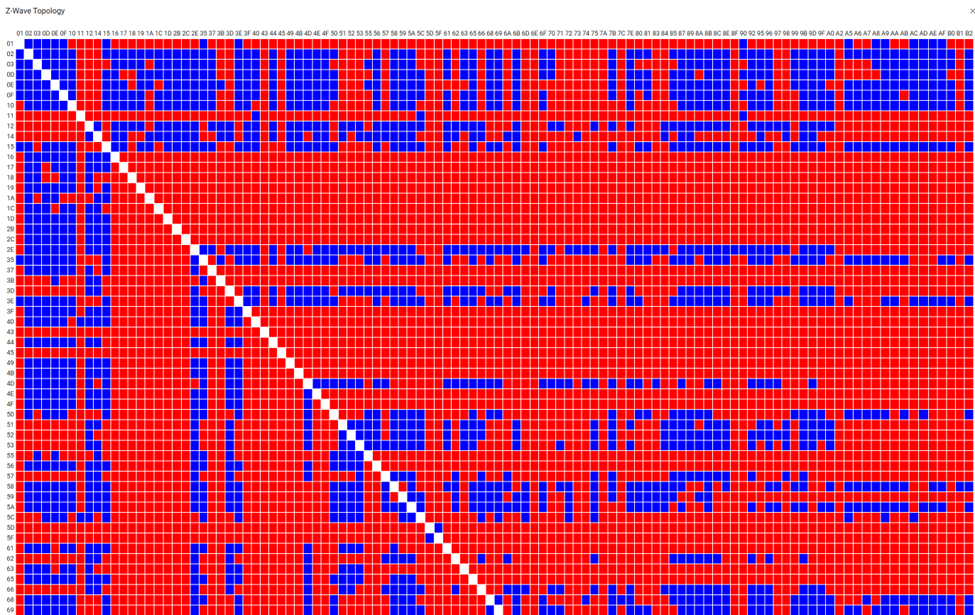

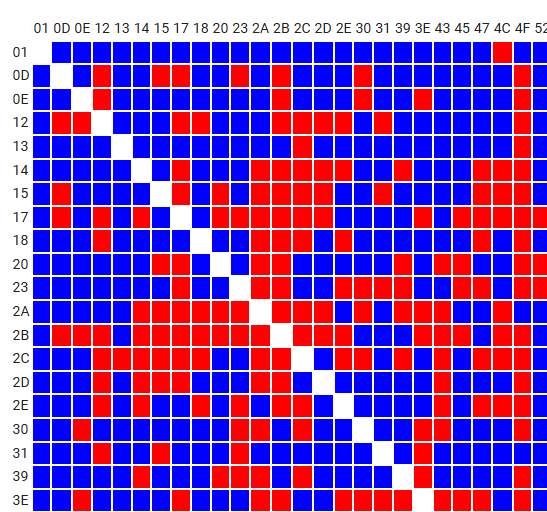

Post a screenshot of your red/blue topology map from the C8. I want to see if it is the same issue I have seen with other people.

Yes. I selected to options to migrate Z-wave and Zigbee radio settings, and File manager files.

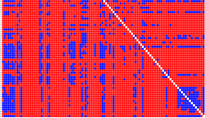

Looks similar to the issue as the other one recently, not sure if they were coming from a C5 or not. The 01 node on the topology has very few neighbors. The issue is that nearly all the devices will be trying route through the devices with the blue in 01.

I don't think that topology is available on a C5 is it?

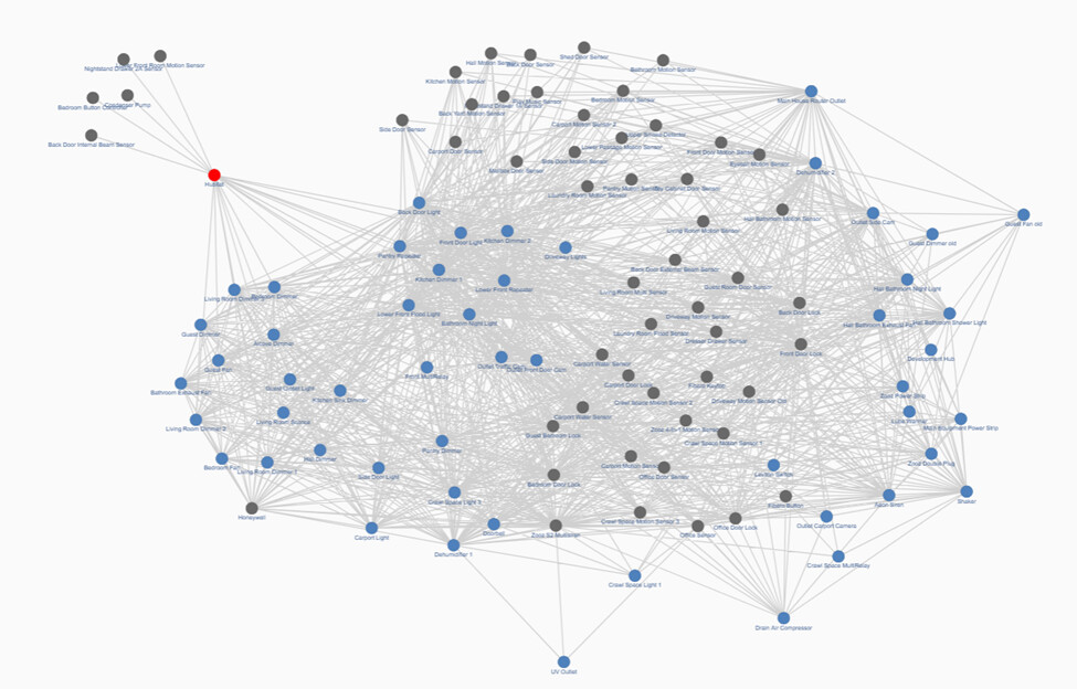

This is more what it should look like:
The C-5 does not have the topology option.

Can you post your z-wave details page in it's entirety? Use windows snip.
Change from channel 20 to 25
