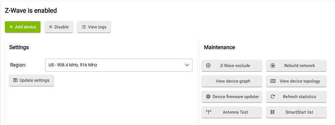

I'm just about to start my migration. Hub is updated to 2.5.1.152. The instructions are clear that I need to make sure my Z Wave firmware is updated. When I go to the Z Wave details page I see:
No indication of the current firmware version. When I go to http://192.168.68.115/hub/zwaveVersion then I see: VersionReport(zWaveLibraryType:7, zWaveProtocolVersion:7, zWaveProtocolSubVersion:14, firmware0Version:7, firmware0SubVersion:14, hardwareVersion:1, firmwareTargets:1, targetVersions:[[target:1, version:7, subVersion:15]])
So I think I have 7.14.1 or 7.15.1? From what I am reading here that is not the latest - I see references to 7.18, 7.22 (which is "bad"?), etc.. Lots of talk about Z-Wave problems and making sure the C7 has the same version as the C8. I am really not up for rebuilding everything from scratch so want to make sure I get this right before I start.

But if your not migrating from Hub to Hub, how do you know if your (single) hub has the latest Z-Wave firmware? Seems like there used to be an icon to update the Z-Wave firmware.
That button is still there but appears only if there is an update available for your hub: Z-Wave Details | Hubitat Documentation.
So, it being there is the only clue you'd need. :slight_smile: (But if you're on Z-Wave JS, it will also show the version in the UI for reference either way.)
One more pull on this thread - in my research saw lots of screenshots where there is a radio firmware revision and JS revision shown. I had assumed that was showing the current rev. I see nothing on my page. Why is that?
You are running legacy Z-Wave, not Z-Wave JS. This information is shown only for Z-Wave JS.
