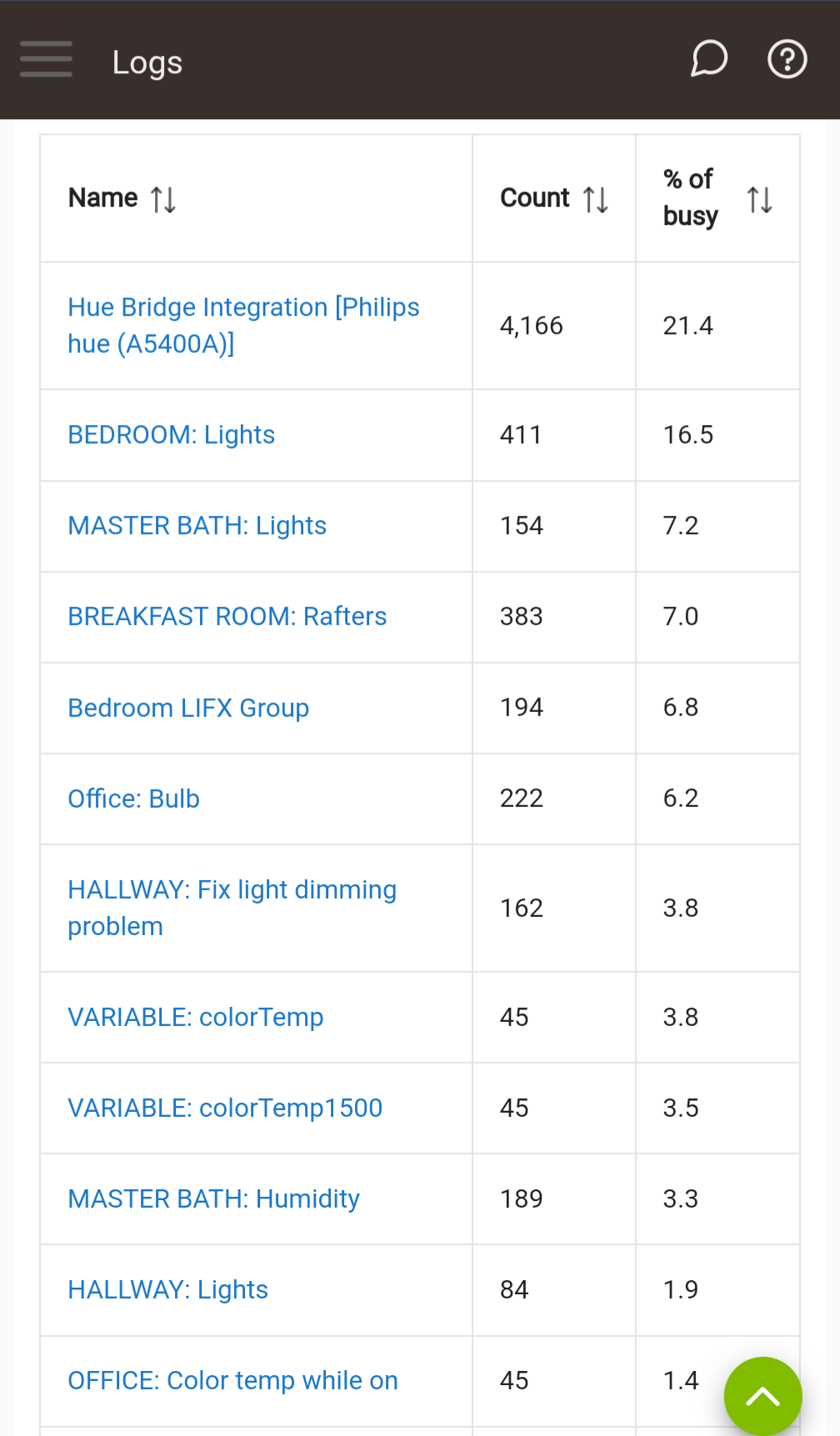

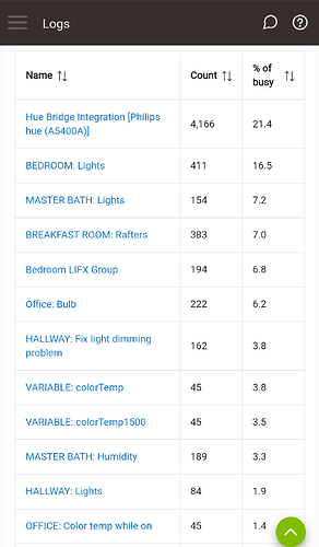

C-8 Pro now. Yep, no slow issues or anything bogging it down. Probably have 30-40 Rule Machine rules going. Google Home, LIFX, Hue, and Lutron. Max busy % is like 11% or so from a LIFX strip.
Is their a place to see the process percentage.
Yes, under the Logs tab: you can view Device Stats or App Stats along the top menu.
This is the apps for instance. Some of this may be helped if I rewrite the rules a bit. I likely have a lot of unnecessary device interactions baked in. Still, plenty of overhead.
That’s percent of busy is not useful unless you also look at the total busy time up above, it is a percentage of that. It’s also not the most accurate thing, mainly just to help troubleshoot.
Well it's definitely better than the 50-60% numbers I was seeing on the non-pro.
