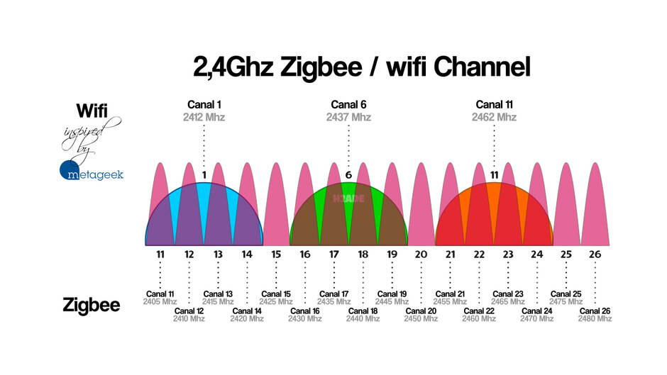

Have you tried swapping the antennas, to rule out a bad antenna, or turning up the power on the Zigbee radio? The default power level now is 8, but originally it was 16, which is what has worked best for me. Also be aware that the C-8 seems more sensitive to interference, if you have it close to your WiFi router. Also make sure your WiFi channel doesn’t overlap with your Zigbee channel.

I am using channel 20 and my C-8 is about 3 feet from the router (next to my C-5 which is off). Yesterday when I tried to re-pair an existing Zigbee device on the C-8 after migration, it would not let me and I was literally just a few feet from the hub.
