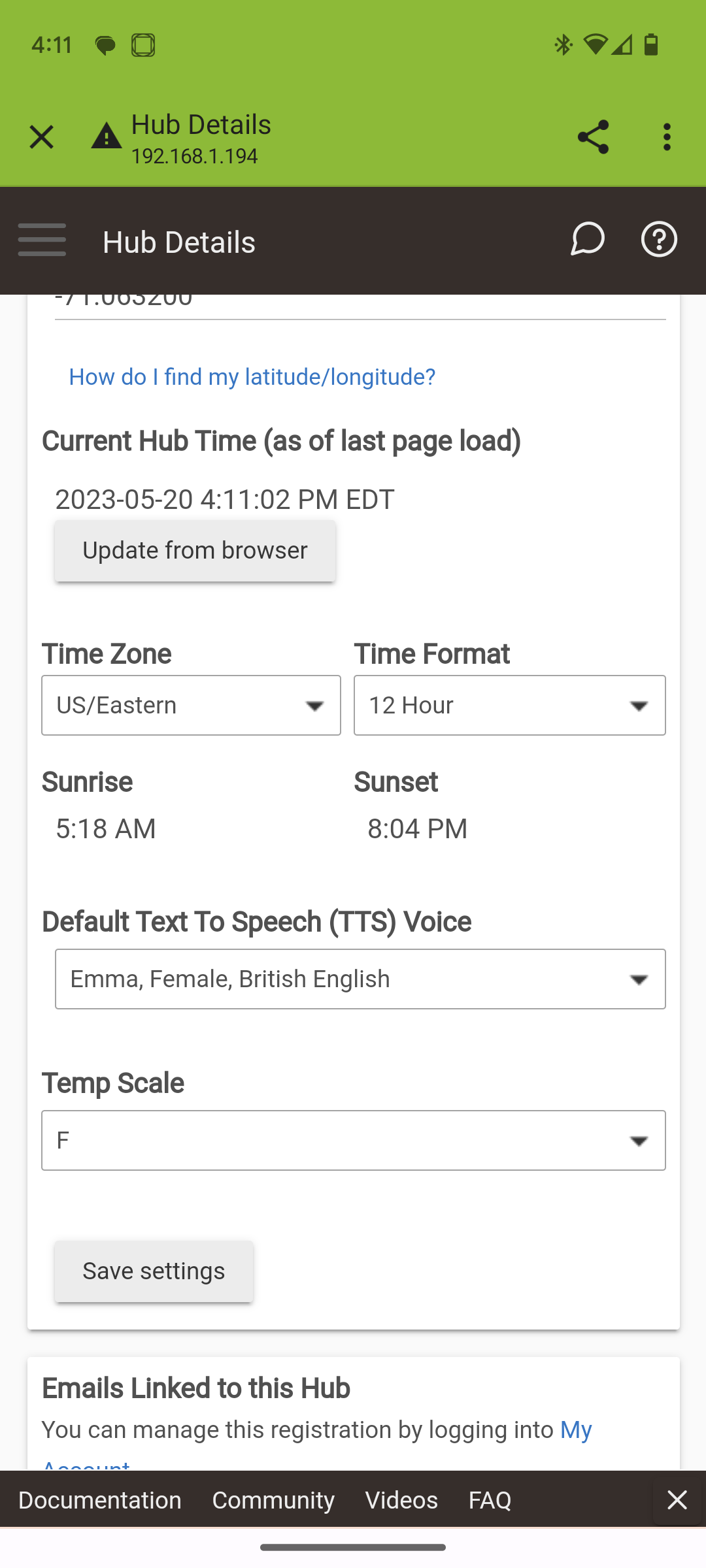

Go to settings and hub details. Is the time there correct for you?

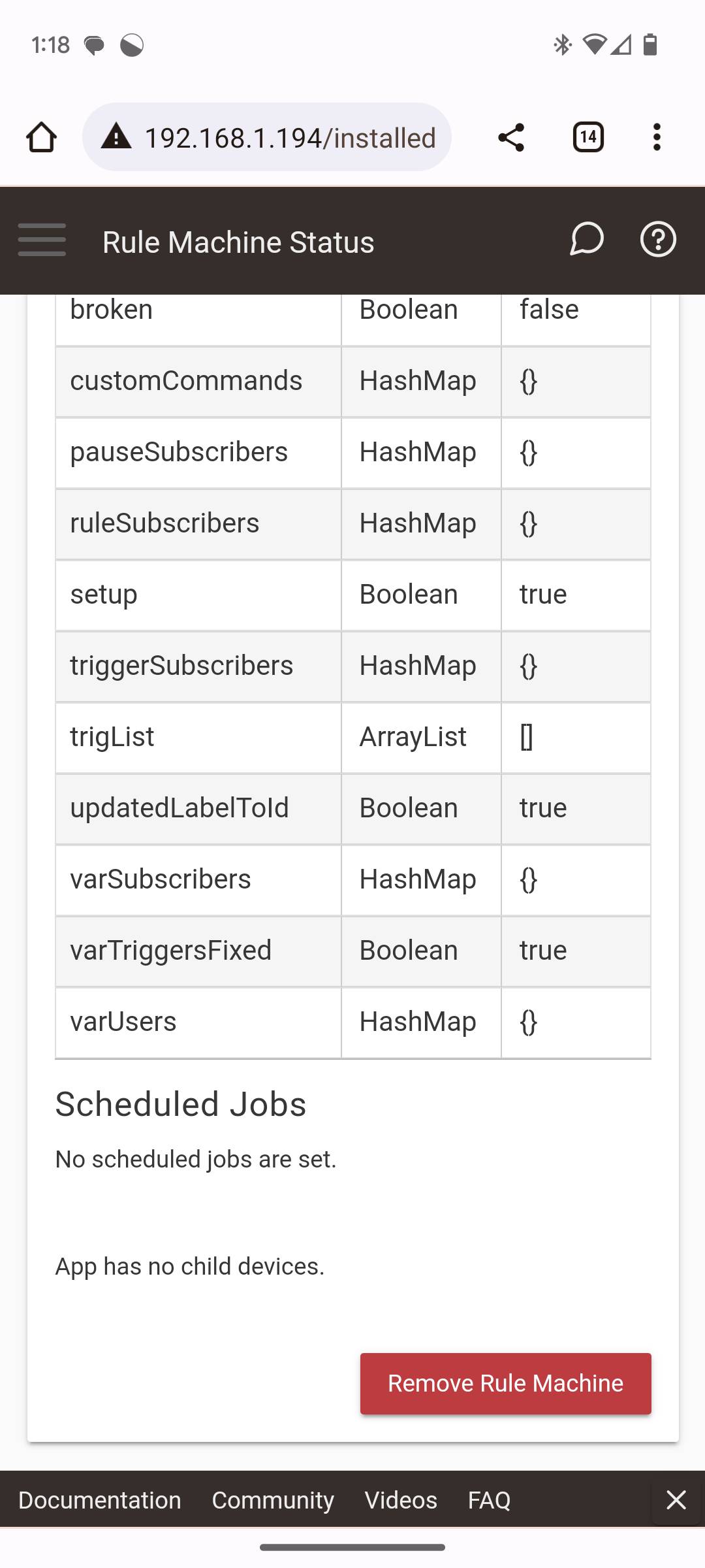

That is very strange. If you click the gear icon next to the app that has a time schedule, if you scroll down on App Details page do you see a schedule? If so, what time?

  1. Yes the time is correct.
  2. I attached a pic of what I see when I click the gear icon and look at scheduled jobs: empty!

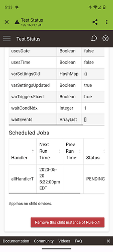

If I click the gear next to my test rule I do see a scheduled pending event:
Looks like the next run time is 5 days ago (today being May 20th), so it will likely never run. Try clicking on โ€œdoneโ€ on the rule and go back to see if it changed.

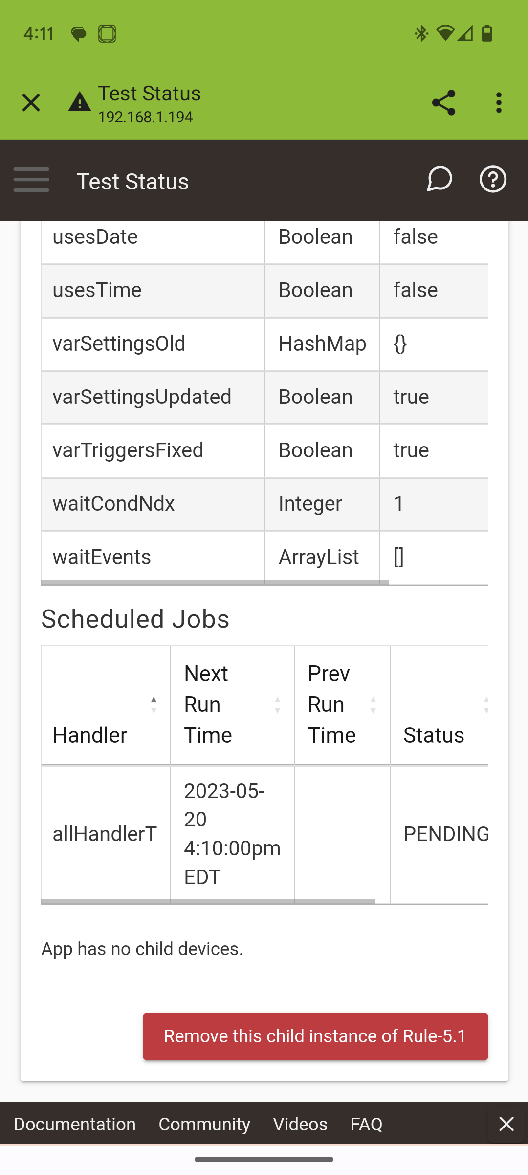

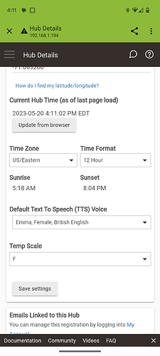

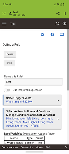

I just ran a test to trigger it, and the time passed with no trigger. Here's a couple screenshots, I didn't show logs in the screenshot since nothing got logged. It shows the device time and the next trigger time.
How far in the future did you set the time? I realize it will likely have the same issue, but could you take a screenshot showing the next run time in the future relative to the phoneโ€™s time?
Sure thing:

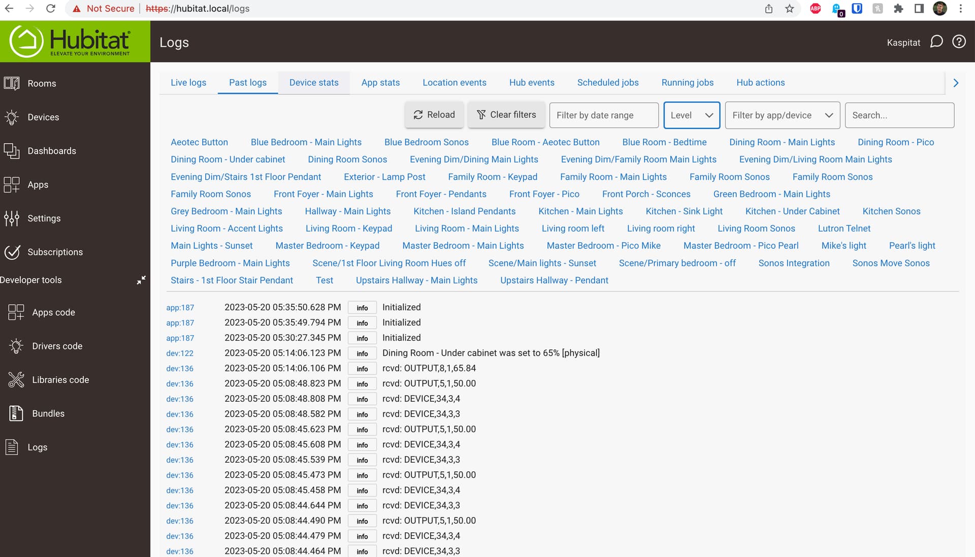

That looks good, from Settings perspective. What do you see in past logs, can you post a screenshot (assuming you enabled logging for your Test app)?

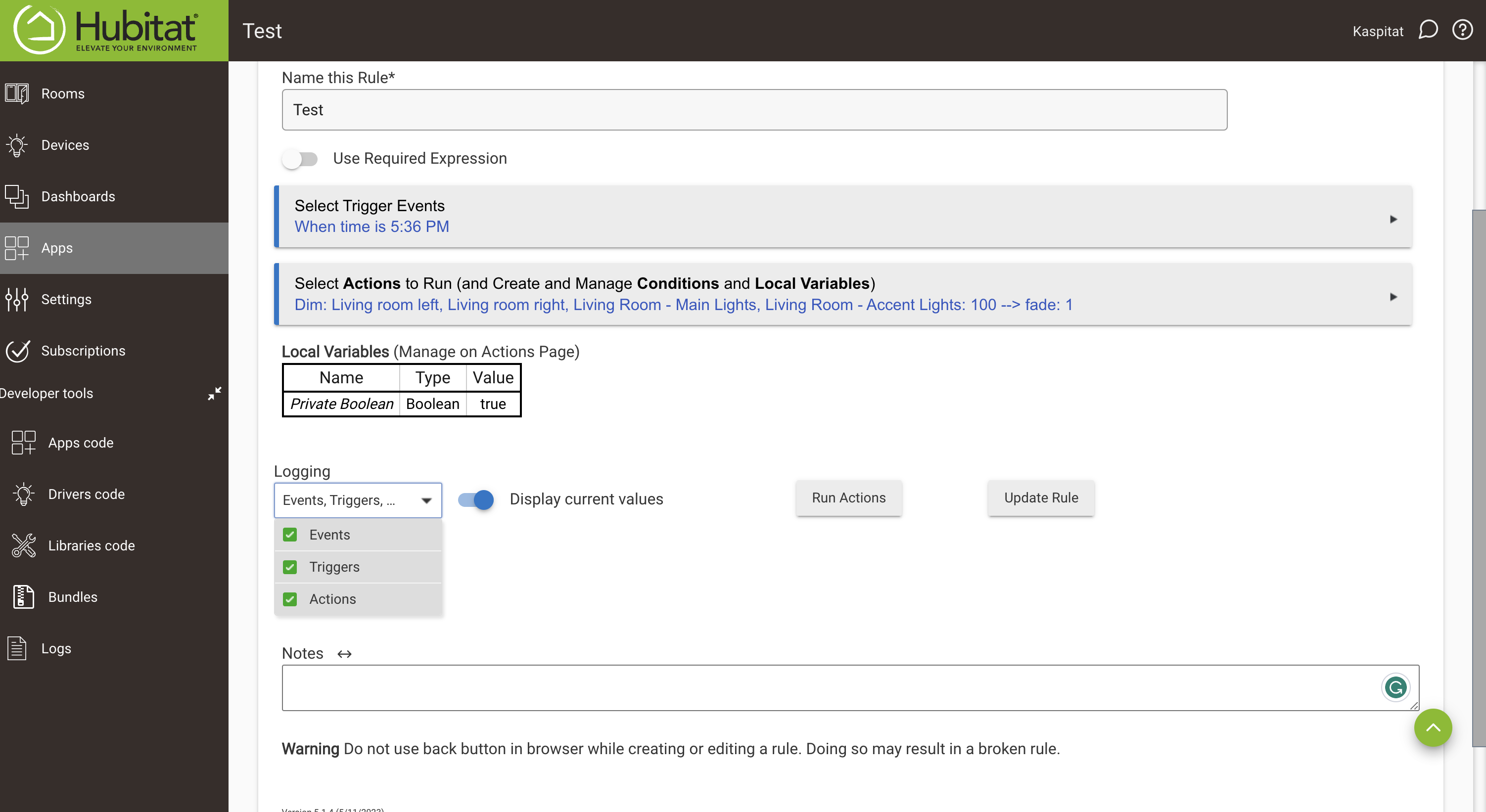

Switched to my computer. Heres a screenshot of the logs around that time. And a screenshot showing logs were enabled for that rule.
