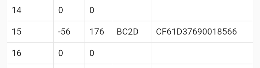

EDIT just did the migration again and I have ch 15 and at least one device has sent it message so far. :grin:

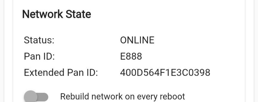

Got everything moved over but I noticed the ZB came back on the wrong channel, 20 instead of 15.
I updated that but I noticed the Pan ID was different too. All the ZB devices are there but no messages so far.
Very odd as I see myself with the correct original ID in a scan but it's not what's in the ZB details
This is after the migration.
Do I have to rejoin everything again?
