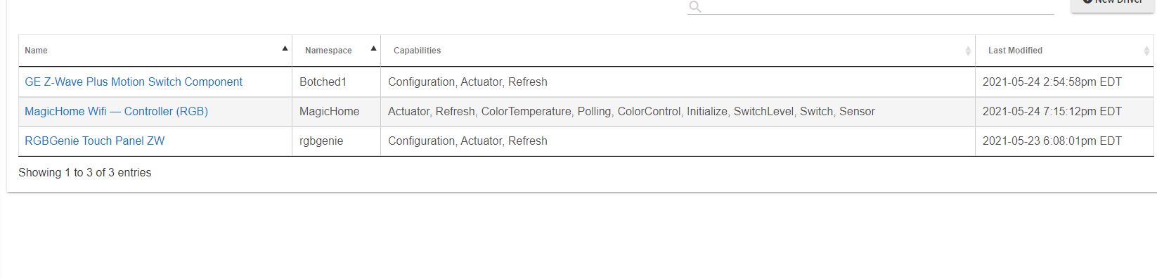

I just got my Hubitat Elevation and I'd like to control from HE instead of the MagicHome app that the manual indicated should be used.
I installed a driver I found reference on this forum:
Under type, I found the device "MagicHome Wifi-- Controller (RGB) which seems right.

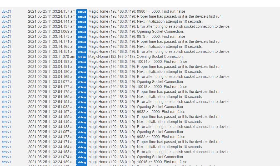

The logs showed many failed attempts to connect, but it finally succeeded. Now I see the correct device state under devices when I turn the controller on and off using the MagicHome app. Yeah!
So, I tried doing the same for the second RGB controller. Different IP address and device name of course, but attempts to connect fail:
I can ping 192.168.0.119:
