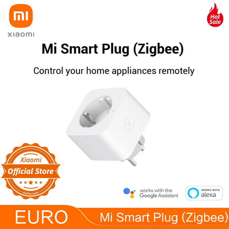

Just received the HE today and started adding my Zigbee devices to it. Aqara sensors are working with markus-li community drivers, Ikea Bulb + Outlet are also working fine.
I am also trying to add several Mi Smart EU Plugs (lumi.plug.mmeu01, I think model ZNCZ04LM) using this driver:
https://raw.githubusercontent.com/markus-li/Hubitat/development/drivers/expanded/zigbee-xiaomi-aqara-plug-outlet-expanded.groovy
It works partially: I can see On/Off events in the log when I physically turn it on or off on the plug itself, and even the current power consumption as well. However, it does not react to any of the commands in HE (On/Off/Toggle). I also tried several generic drivers, but none worked. Is there any chance to get this working?
I also found a driver here, and with that one I can turn the plug On/Off, but power consumption does not show correctly: Xiaomi Mi Smart Plug (New Model) Device Handler - #31 by dotan_shai - Devices & Integrations - SmartThings Community
It's this plug:
