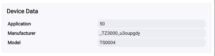

What are the device model / manufacturer ID's ?

Change the driver 'Type' to the HE inbuilt default 'Device' driver, then click on the 'Get Info' button. I will need the fingerprint, as shown in the live logs. This device fingerprint is currently not in the Muxa's Zemismart driver.
dev:22482025-03-05 01:29:25.522 PM
info
fingerprint profileId:"0104", endpointId:"01", inClusters:"0003,0004,0005,0006,E000,E001,0000", outClusters:"0019,000A", model:"TS0004", manufacturer:"_TZ3000_u3oupgdy", controllerType: "ZGB"
dev:22482025-03-05 01:29:25.421 PM
trace
ZCL version:03
dev:22482025-03-05 01:29:25.418 PM
trace
Software Build Id:unknown
dev:22482025-03-05 01:29:25.415 PM
trace
Model:TS0004
dev:22482025-03-05 01:29:25.413 PM
trace
Manufacturer:_TZ3000_u3oupgdy
dev:22482025-03-05 01:29:25.316 PM
debug
getting info for unknown Zigbee device...

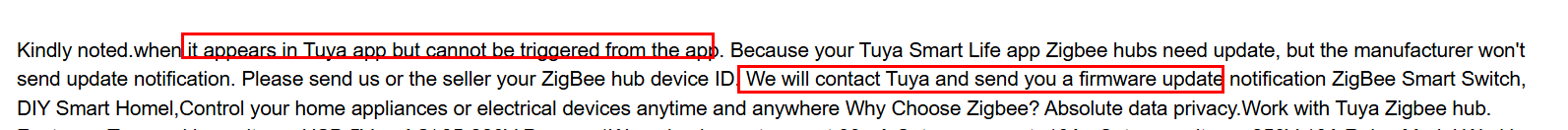

Yes, its better to return it.. The eBay seller warning is also strange, usually the Tuya devices are working out of the box with the Tuya Zigbee hubs - no special updates must be required!

The broken english doesn't help, but it seems to just be a warning about how it can have issues with the Tuya Zigbee hub via the Tuya phone app, if the Tuya hub is not updated to some level, but Tuya doesn't notify you about the hub needing to be updated to use the device. So they are just letting you know you many need to update your Tuya hub. That is my take on it.
Nothing to do with connecting it directly to Hubitat, though.
