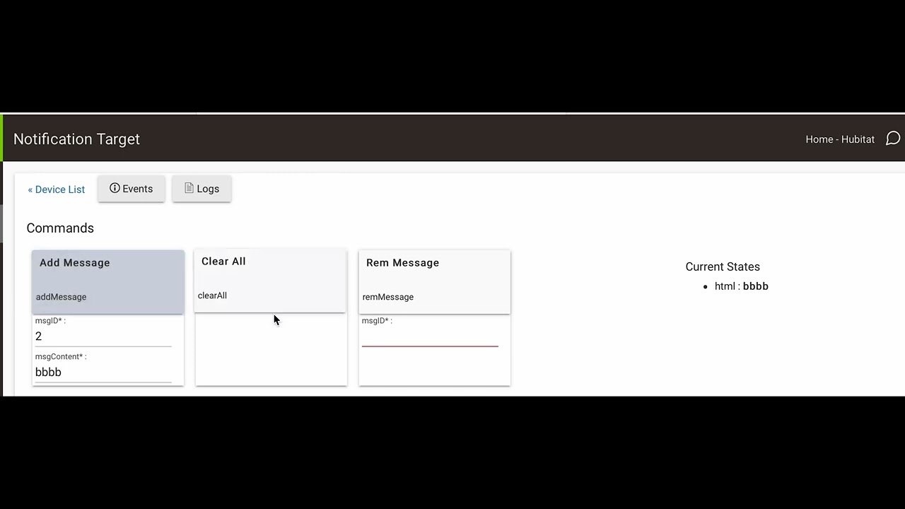

I'll try and video it and post a link
Helps if you put the If statement in the right place… try v0.0.5

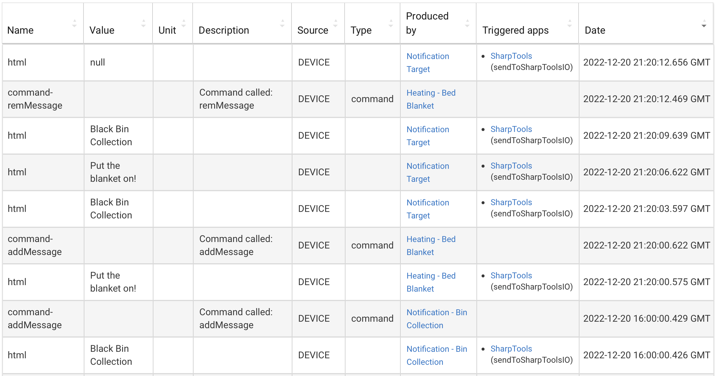

Aargh! I broke it again. It has been running normally for several weeks. Tonight one alert was showing, a second message popped up that I acted on 12 seconds later (which cleared that second message) and it went straight to 'null' at that point. No logs unfortunately, just the events from the device:
I've not a clue what has changed but previously I couldn't get it to fail.
Could have sworn every loophole had been closed, but guess not. :sunglasses: I should be able to take a look at it today.
Thanks @thebearmay - it’s nothing critical as it fixes itself the next time an ID is added or removed.
After the last update I messed around, timing the removal of each ID at different intervals to try and get it to fail with ‘null’ but I couldn’t. Yesterday it just happened out of the blue in a similar manner to previous. I’ve switched debug logging on, in the event it happens again and can provide any information useful for diagnosis.
