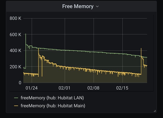

i seem to be seeing about a 25kb memory leak after each firmware backup on my hubs.. think that is whay eventually it gets low enough and i need to reboot. For now i am going to disable the nightly backup via my nas.
ie
Summary
you can see the cpu spike at the end of the graph during the backup and the loss in memory.

yes unfortunately that last event in the post was on the latest build you can see the big spiker where it updated.. i regularly do a backup immediately ie 30 minutes after an upgrade so i have one

Guys the drop is related to the backup but the recovery is related to how Garbage collection works. It won't immediately drop something out of memory, It is more likely it is remaining in memory for some other reason GC has determined it might be useful. especially if it doesn't have memory demain at the time requiring to be moved to a lower priority memory location.
The below graphic also shows the memory usage and recovery from the Backup Process. You can see dips at around 2:15 several mornings and then another at 4:40am. One of them is the nightly scheduled job on the hub and the other is created by my unraid server running a simply script to create and download a new backup. The key with this graph is you can see that it is already down to around or even below 200MB of memory. The hub is was running fine through this interval, but one key factor is that towards the end of that graph the memory drop was practically stable and not droping much at all any more.
Memory consumption is based on demand so you have to ask yourself what are you doing that is continue to pull that much memory. but i really don't think memory loss is being caused by the backup procedure.
