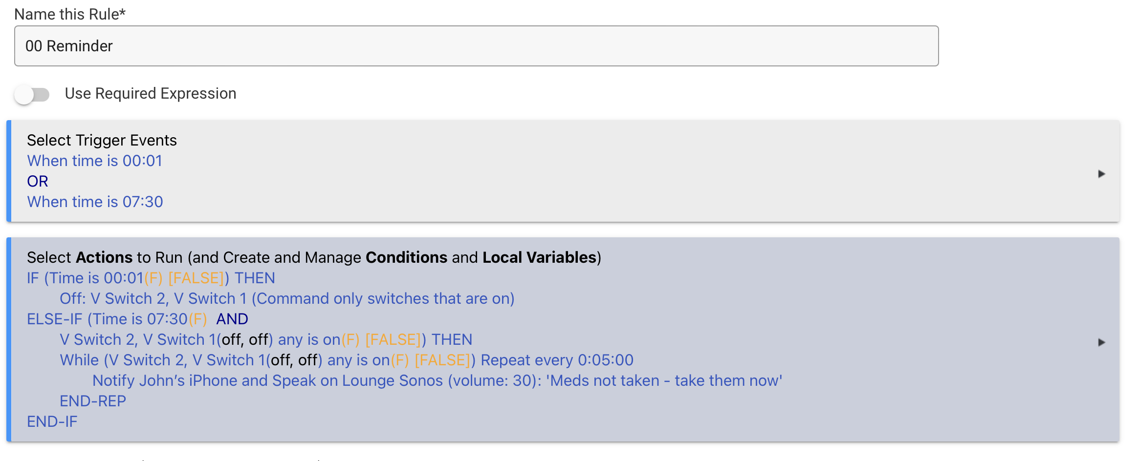

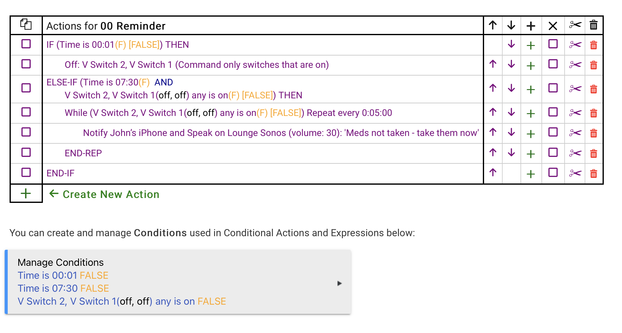

Here's an example with notification to phone and Sonos repeating until the switches are off:
I've done the above such that the two switches are grouped. It could be amended further so that the announcements are individual to Tim or Lisa (I'm guessing you've done two NFC tags)
Edit: I just noticed I used 07:30AM not PM...adjust to suit
