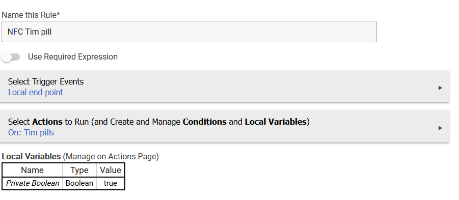

I have setup an NFC tag to scan which changes a virtual switch to on when I take my medication via a rule machine rule.

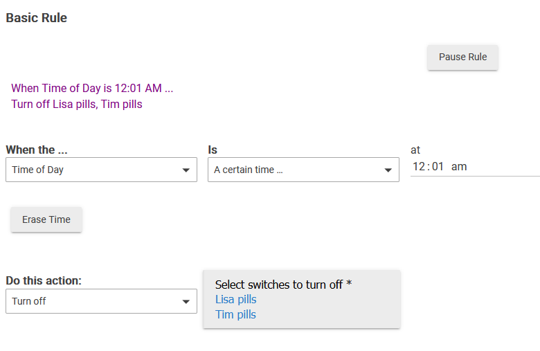

At midnight the virtual switch resets to off via Basic Rules.

There are multiple ways to do it. You could add an RM rule for 19:30 with your actions or redo the basic rule as an RM rule depending on your preference.
Triggers
Certain time 12:01 Am
Certain time 7:30 pm
Actions
IF time is 12:01 Am then turn off switches Lisa Pills, Tim Pills
ELSE-IF time is 7:30 PM AND Lisa Pills or Tim Pills is ON then....add your reminder actions

@johnwill1 does this look right to you using RM?
I could not get an "ELSE-IF" in the same line in the middle of the rule. Sorry I am fairly new to Hubitat so know its me thats not doing the correct thing.
That looks fine. Yes it's a bit tricky until you get used to it, but the more rules you create, the easier it gets, trust me!
Once you've started your conditional with 'IF', and you've added the first 'THEN', you'll see the options on that same page for 'ELSE' and 'END-IF'. To get the 'ELSE-IF' you click done, then click the + to add the next action, select 'Conditional' and you'll see the 'ELSE-IF' because you have an unfinished conditional.
Strictly speaking your method is correct not mine....As there are only two possible triggers, IF it isn't 12:01AM THEN it has to be 7:30PM otherwise the rule wouldn't have triggered. My ELSE-IF might be more used if there were more possible outcomes.
There are always so many different ways of achieving the same goal in RM and if the rule works as intended, it doesn't matter how you get there.
Thank you for the extra explination @johnwill1
The rule triggered and reset as I wanted. Many thanks for your help!
