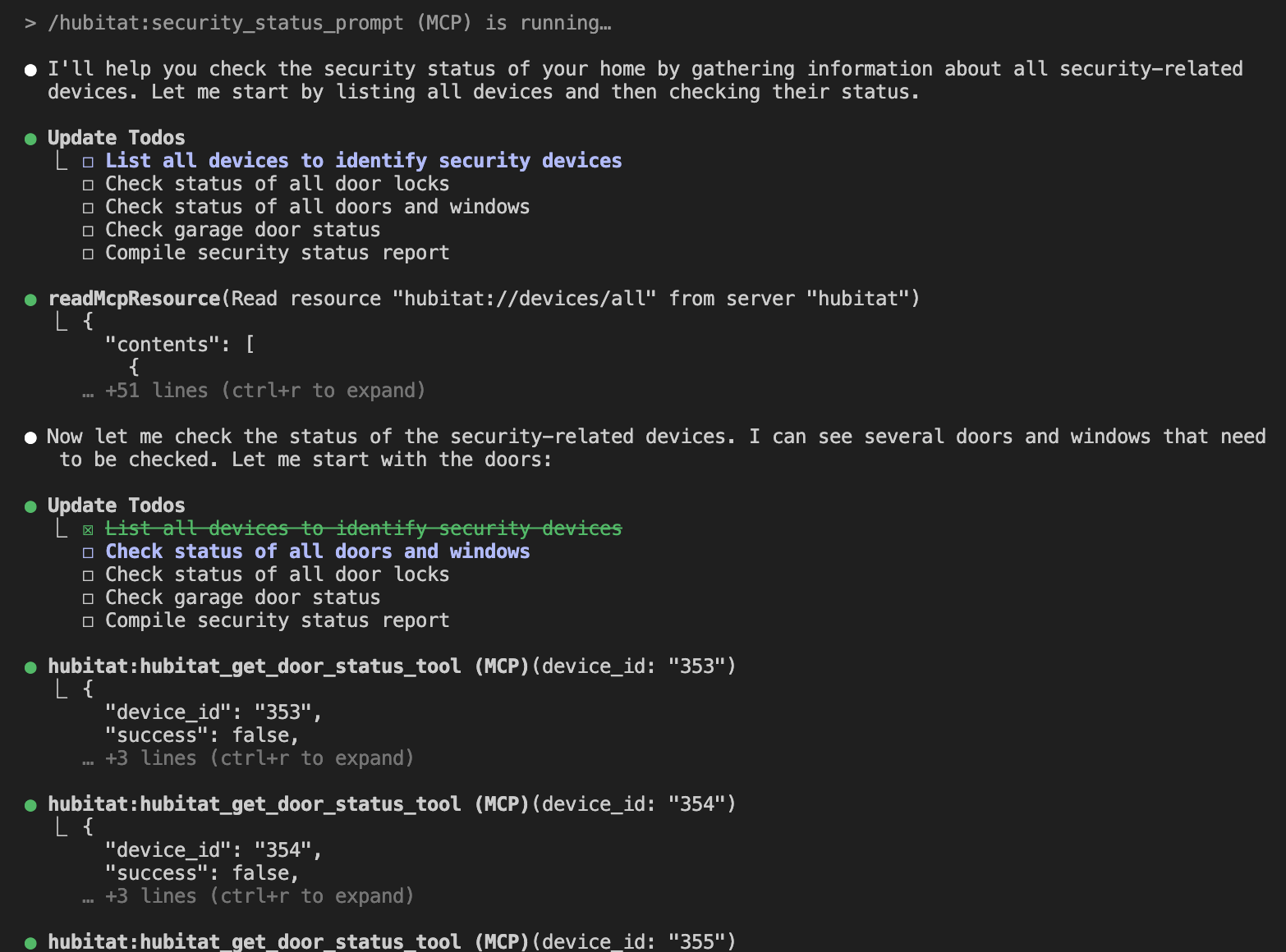

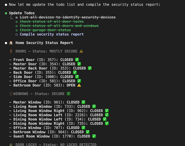

I had some time finally and wanted to explore MCP capabilities so created a MCP server that integrates with maker API to provide tools and resources, and includes some custom prompts to show what could be done.
Here are a couple of screenshots from part of a session using claude code to run a security status prompt (prompt provided by the hubitat MCP server):

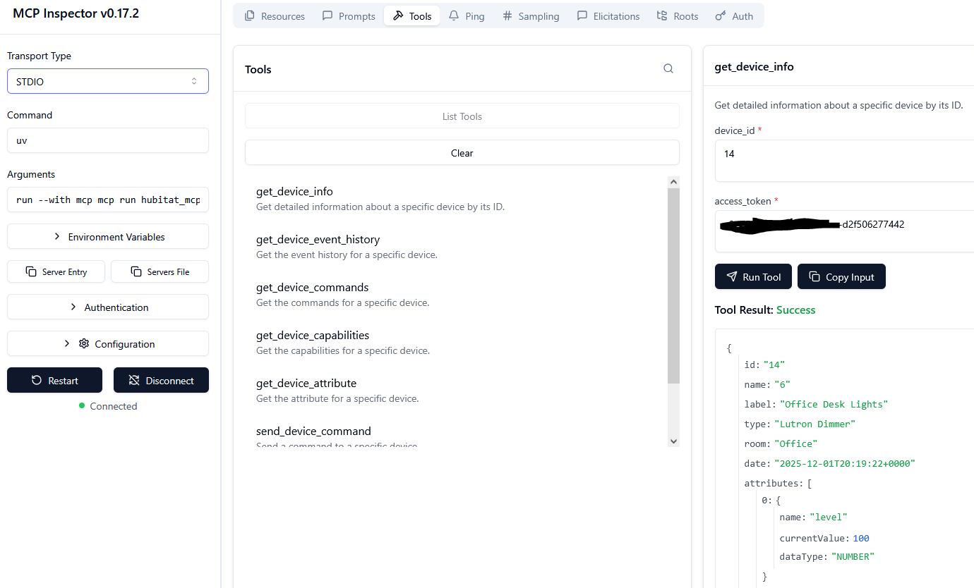

I wrote a Hubitat MCP server in python and it is working with VS Code and MCP Inspector as the client.
