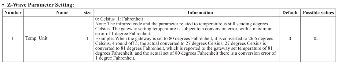

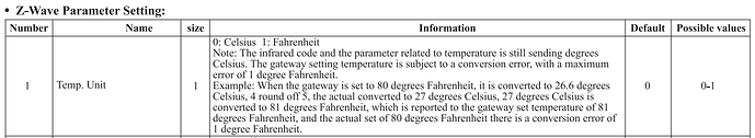

I've read that parameter description three times and, while I understand what each word means individually, I have no idea what they are actually trying to say. :slight_smile:
I also cannot find this product on the Z-Wave Alliance website (hoping the certification docs would have parameter descriptions) or any manual for this particular model on the manufacturer's website.
If this seems like it would be a useful addition to the built-in driver, I can help with that -- as long as someone can say what it actually means, and ideally whether there are any firmware restrictions that would affect if/when it is available. If this affects how the device reports to the hub, then, as mentioned above, this is usually set automatically by the driver according to your hub preferences. It looks like the driver is already trying to accommodate that.
The built-in driver actually does have knowledge of a few configuration parameters that weren't exposed in the UI, I think, by accident, but this wasn't one.
All that being said, the new "Generic Z-Wave DT Thermostat General" driver should also work for this device, at least as far as offering all configuration parameters the device offers should go. This is in platform 2.4.0 (and newer) only.

Just to be clear… parameter 1 toggles the display (F or C) on the physical thermostat. There’s no UI on the device itself to do this.
