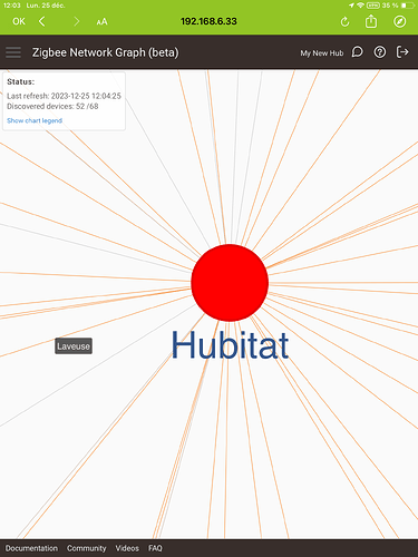

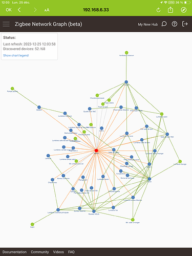

Below is my Zigbee mesh, and I count at least 35 devices connected directly to the hub (orange lines), not even counting the grey lines, and the graph is not done generating yet (52 out of 68 devices)

The zigbee mesh graphic is not actually giving you a live map of all devices actively connecting to your hub. There are several caveats and gotchas associated with the data it’s presenting.
See this thread, for example.
That map is pretty, but highly unreliable to interpret in the manner that you are. It simply reflects the last reported routing path for those devices. It doesn't mean that all 35 of those routes are currently active.

Ok, thanks. I guess I read more than there actually is into the map.

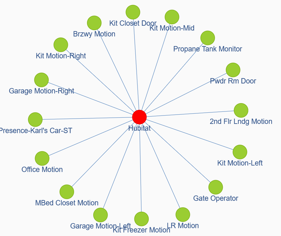

I am pretty sure that the 32 device direct connection limit applies to Zigbee End Devices only. Zigbee repeater devices do not count against that 32 device limitation. In the Zigbee Graphical Map display, only the green devices, directly connected to the hub, count toward the 32 device limitation. The blue devices are all repeaters.
Well, I'm up to a legit 16. Not sure if I'll ever get to 32, with no repeaters, but you never know.
