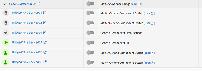

So I have the InvisOutlet Aura, that just got sent to the backers. No I have installed the "Matter Advanced Bridge" and that was able to create 6 child drivers and it created:
Working: Matter Generic Component Switch (Top outlet)
Working: Matter Generic Component Switch (Bottom outlet)
Working: Generic Component Omni Sensor (Illuminance)
Partly Working: Generic Component RGBW (The CT version Works, but the RGB does nothing)
Not working: Matter Generic Component Switch (Hidden Touch Button Top that can be used to turn on outlet or configured to run a scene) Setup via app
Not working: Matter Generic Component Switch (Hidden Touch Button Bottom that can be used to turn on outlet or configured to run a scene) Setup via app
Let me know what other info you need. more than happy to provide

Also its still only getting the CT driver instead of a RGBW driver (When manually switching only the CT part works)
Refresh the device web page - how many child devices do you have?
(the logs look good, the buttons are sending events to the child device)
Please click on the reSubscribe button and try again
Let's try to get the buttons working first...

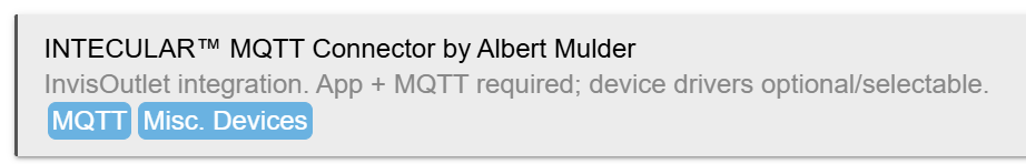

so matter seems to be sluggish at times and not updating status reliably, so I have created MQTT drivers for connecting to them, live in HPM.
