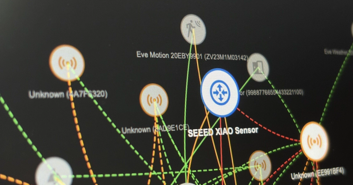

Well if HA can do it Hubitat can too, but it doesn’t look it became really useful until thread 1.4, which isn’t that old or widely adapted yet. So depending on device MMV? I’ve heard rumors that there are big matter changes coming in hubitat 2.4.4 so maybe? or it could require a hub with a thread radio. we’ll see.

This sent me down a fun rabbit hole this morning. For Thread routing visualization, the answer very much depends on the devices that have been connected into Hubitat. Theoretically, it is possible for Hubitat to read the ThreadNetworkDiagnostics Cluster (0x0035) and see the tables (neighbor, route, etc...). The big catch is if the thread device actually exposes the necessary cluster information as not all devices do.
With the above said, it would be significantly easier if Hubitat (in the future) releases a model with a Thread Radio and becomes a Thread Boarder Router too. In that scenario, this becomes significantly easier and I would expect their to eventually be an internal "app" similar to what is provided for Zigbee in Settings.
