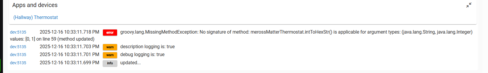

get a error

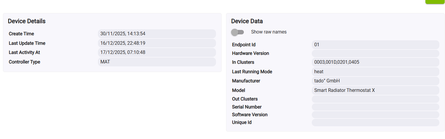

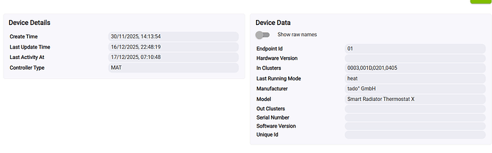

I don't know why its not working, what is the actual thermostat being used?, also can you post a screen shot of the data section of the driver details?
Tado thermostat and TRVs

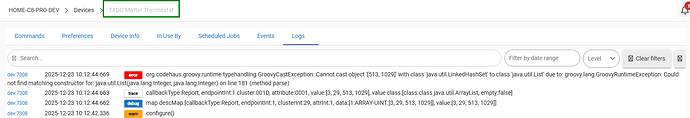

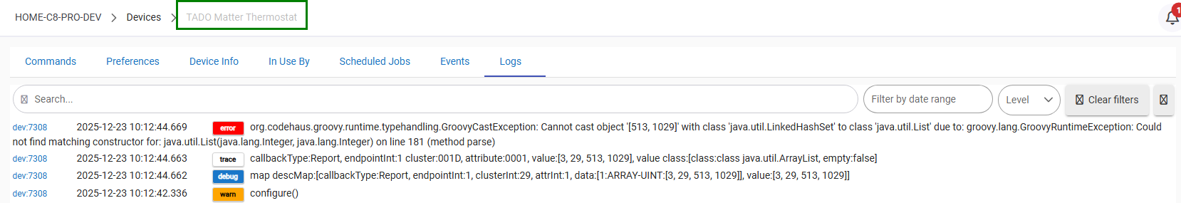

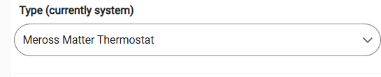

And when you switch to the generaic matter thermostst driver, then click configure what happens?
There is an exception thrown by the Generic Matter Thermostat driver :

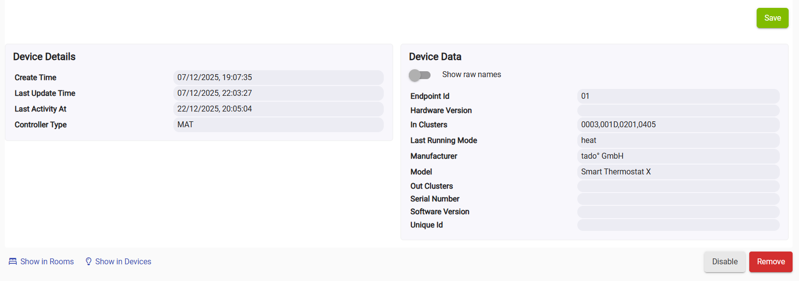

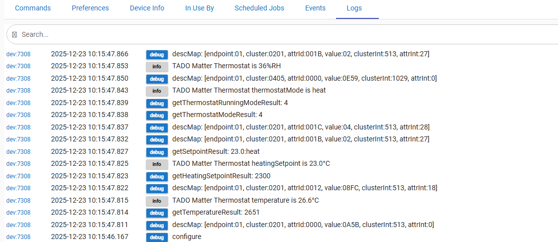

The 'Meross Matter Thermostat' driver is working OK with my Tado X (TRV):
As @kkossev said and nothing works, none of the commands seems to do anything.
That's very helpful, thanks!
Found issue, shoud be fixed in an upcomming 2.4.4 beta
