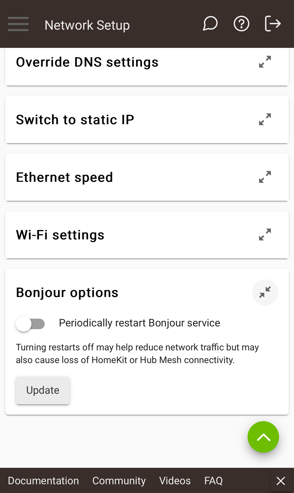

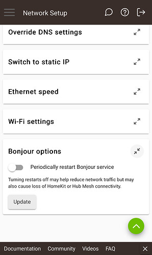

So I turned off the Bonjour restart option, and it hasn’t happened since.
